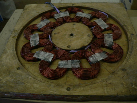

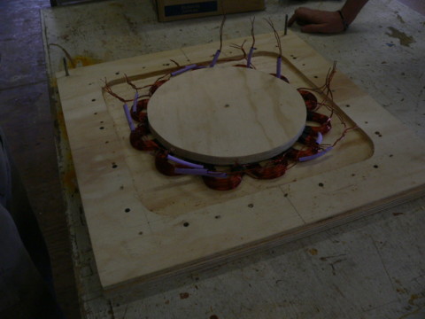

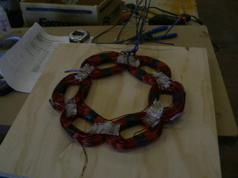

They used a big plywood disk to hold all the coils in place while they made connections for the 12' diameter machine.
The stator for the 10' machine is ready for casting.

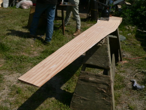

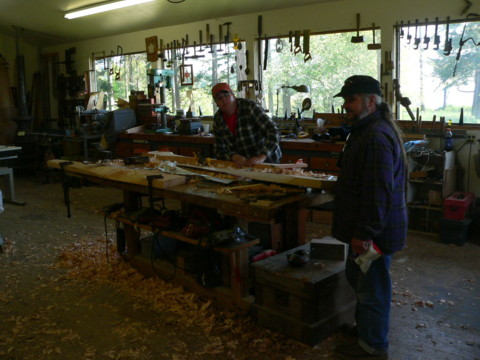

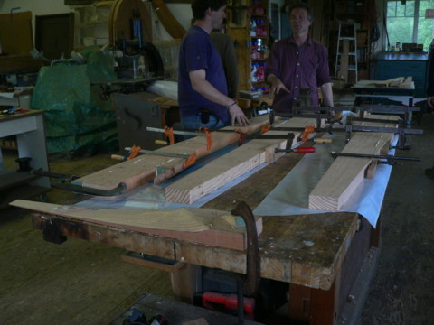

The lumber for the blades on the 12' machine wasn't wide enough so they had to laminate some extra on there.  This got done on the second day.  All the wood for the blades was very hard and fairly difficult to carve.  Getting the blades done on time was tricky but it happened.  Lots of work.

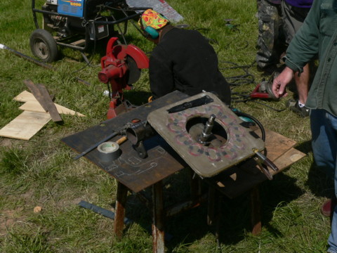

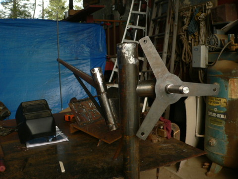

Finished metal work for the 10' machine.  George gets very picky that everything look nice - so while the students did all the welding, if it didn't look good he made them do lots of grinding and in some cases start over.  The end product was very nice.

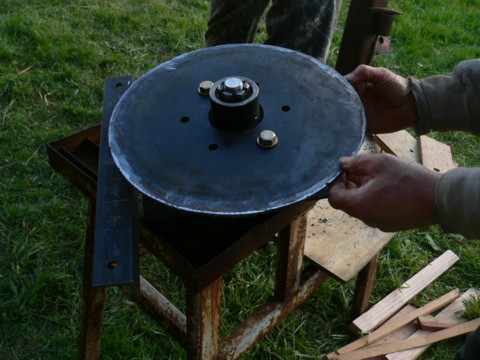

For the 12' machine they bolted square pieces of metal to the hub and flame cut the 16" disks.  They came out real nice.

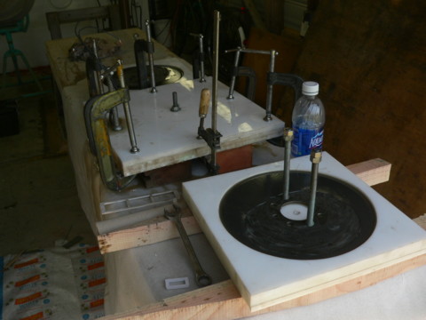

Casting the stator and magnet rotors for the 10' machine.  We brought our own plastic molds for this.

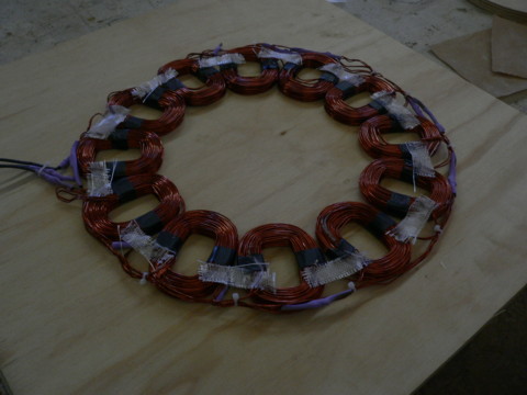

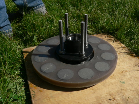

Here's the stator for (ready for casting) for the 6' machine.  See what I mean about the magnets and the coils being sideways...  I expect this might spur some discussion here.  Bottom line is - it worked fine and it seemed to be a good match for the 6' blades.
The stator for the 12' machine ready for casting.
We had them cast the magnet rotors upside down again for the 10' machine - they came out nice.  This 10' machine uses the 2" dia x 1/2" thick round magnets and it's wound  for 48V with 105 turns of 15 gage wire per coil.

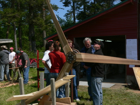

A finished blade for the 12' machine.  Well... I had planned on breaking this up into two parts.  I should've sorted pictures better and kept it shorter but too late now.  I'll finish the story in part 3.

Interesting that 6 ft machine, placing the magnets that way overcomes the problem of lack of space at the centre of the stator if you use a conventional hub. With the magnets placed that way the thing would be better with an overlapped coil design, but it makes a very difficult thing to wind.
I have built machines of this type with magnets the conventional way using a blank disc to return the flux but I built my own hub. I have suggested this construction to others but they have run into the space problem at the centre. This seems a perfectly logical solution. I suspect the matching will be quite reasonable for 6ft when loaded in the conventional way.

I've wondered about laying things out sideways. Would there be any pics of the magnet arrangement for that 6 footer?
