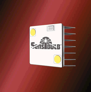

Does anyone have experience with Sensibulb lights?
Hi
I asked on the SSCA (Seven Seas Cruising Association) forum about LED light products, and got a reply mentioning the Sensibulb LED lamps. Does anyone here have experience with them?
http://www.sailorssolutions.com/
I live full time on a sailboat and get my electricity from solar power (a wind turbine is on the workbench). Apart from one dome light with an incandescent bulb, all my lights are fluorescent which has a tendency to make me feel like I'm in a hospital.
I was going to make my own LED lamps following the excellent advice given elsewhere on this forum by commanda, but these things look better than anything I could make, not only in form, but in function. At 40 dollars US per bulb, they are not cheap, but not too bad compared to some of the crap that is sold for boats.
A friend of mine recently bought a boat that had LED lamps from Budget Marine. They failed within a couple of weeks. Budget replaced them for free, and the replacements failed within a couple of weeks. The LED's failed in groups of three, so I suspect they just use resistors in series and could not deal with the voltage fluctuations on a boat.

I would still DIY but I would not build my lights Commanda style because I really don't like the output of the 5mm LEDs she's using. The newest Cree and Seoul LEDs produce about 40 lumen/watt and are just so much better, more light yet less electricity, than the 5mm LEDs that I think there is no point in using them. Prebuilt pwm regulators are available for as little $3/ea and the best binned LEDs are about $6/ea. This would allow you to build nice, small, and dimmable lights that would have much better color rendition. LEDs have improved so much in only the last six months that unless you see one for yourself you won't believe it.

I'm afraid I have a negative experience with Superbrightleds. A year and a half ago, I bought a couple of their bayonet bulbs from another cruiser I met in the Cape Verde's (west coast of Africa). He had ordered more than he needed and was covering his costs by selling them to other cruisers.
The LED's failed within a few months, burning out in groups of three. I sent an e-mail to Superbrightleds describing the problem and specifically pointed out that I was NOT looking for a refund. I was simply asking for advice, as I was interested in replacing the bulbs, but did not want a repeat of the failure. I received a very curt e-mail where they basically said I must have used a product meant for cars rather than boats and that it was not their problem if I chose to do something so stupid.
Well, I have lived on a boat for quite a few years now, and I believe I know a bit about the electric systems of both boats and cars. The main difference between the systems is that a boat usually has more battery capacity, a higher capacity alternator to match and other (normally well regulated) charging sources in addition to the alternator.
I can not see any difference between a car and boat electric system that would affect the performance or longevity of LED bulbs. The bulbs I installed were never subjected to higher voltages than normal alternator charging in a car. Unlike a car installation, I never started my engine from the same battery as the LEDs were operated from, so there would be no transients.
I took their e-mail to mean that they did not want my business. I have decided to honour their wish.

If this is the case then you may want to continue following Commanda's master class and hope that someone wants to take on the job of having boards built or sourcing the parts. I have a few DIY lights built with 5mm LEDs on my boat, Merit 23GP "Between the Sheets", and I've never had a failure but I just can't stand the color. I don't live aboard so I put up with it. Once Commanda finalizes the circuit you might look at the Pirahna warm whites and then build modules to fit into your existing fixtures.
