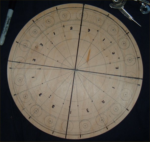

The 1" diam. mags do not have holes in them--- I simply used 1" washers to do my layout board. Everything is centered and balanced.
The thing already must weigh 40lbs. However, all 40 of the magnets only weighed 2.5 lbs. I doubt I'm going to get much power out of this one in low winds. I was hoping for 20-40 watts in a 10-12 mph low summer breeze/wind. I was thinking of an 8' rotor and controlling furling ONLY with the variable pitch blades via the adjustable spring in the center. (Now that its summer time,,i was hoping to get as much power as possible out of the lower winds (7-15mph), even if it means sacrificing high wind power.

I plan on a 3/8" thick stator and close to a 1/2" magnet to magnet air gap. I did a test coil with the 1/2" magnet air gap and using my 16 GA. wire. I did 64 turns, but it was too big for the spacing. (55 turns should fit) Anyway it only showed about .3 volts @ 60rpm and 1 volt @ about 150 rpm. (guessing) I held the coil in there with my hand. That is way under what I hoped for. I guess the flux is somewhat weak for those little mags and that air gap. I guess I can always use small ga. wire to get the volts up. Its for a 12volt system. I was thinking of a star hook up. I want the stator to be 3/8" thick for minimum stability and less possible warpage.
But only 1 volt is only 5 volts per phase @150rpm. --Which is not going to swing it. Did I even do the 20/15 layout right??  I thought with 40 mags I would've got more than this. Anyway, any help would be greatly appreciated!

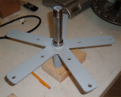

Ok, I did further testing. I secured the same test coil on one of my stator bracket bolts with alittle piece of plywood and taped it down. Now I am getting .7 volt(AC) @ 60 rpm //and 1.4 volt @120rpm. So it looks very close to 1.6 volts (AC) at 150rpm. This is with 64 turns of 16ga. I should be able then to get 70 turns in the space (2"OD for each coil) easily. This allows some room for 'not so tightly perfect' wrapped coils.  So,,, 1.6 x5 =8volts.  / Star connection is 8 x 1.73 =13.8V ///13.8 x 1.4 (ac to dc) =19.3 volts.  That sounds more like it! However, If the final open voltage is something like 24 volts @150 rpm, could I have a problem with early SLALL??  The alternator will be about 100 feet away from batts. It also would be nice to open the mag air gap another 1/16" for more 'safety room' incase the rollerbearings loosen a bit. I think this will work. If it did stall early, I could open the gap alittle which is what i would like anyway.  -Thanks amillion!

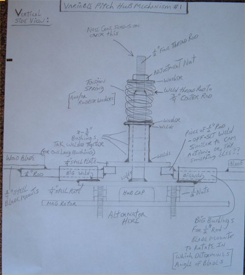

I also had a little question about the Variable pitch hub and blades I am going to try to make.(for Flux or anybody)
I would appreciate brief opinions.  Below in Rpcancun's question I posted the basic design I am thinking about trying first. My question is: CAn I make my 3 blades with a 12 degree angle all the way down the blade clear to the tip, in order to, as the wind mph (and thus pressure on the blades) increases, the wind will slowly turn the pitch angle all the way up to 0 degrees and then go past zero degrees alittle bit to air brake? This method seems the best way to go, since it seemingly would also increase efficiency when the blades go to a steeper angle as the wind speed increases, causing less drag and thus increased speed. I do not quite understand "feathering" the blades in the other direction since it would cause more drag. It is difficult to even explain this without drawings. Sorry about that.

It put my last comments in the wrong place. I will put the drawing here.
I have only seen one drawing of a variable pitch hub---and it was incomplete. So I am going with the first most obvious design in my brain. It would be nice if I could see some other designs instead of remaking the wheel again. But I can't seem to find much info. on variable pitch hubs. I drew the basic idea of what I am going to try to make first. I may add 'linking rods(arms)' to the blades  later if the angles of the blades do not stay close enough together with the center control bushing.  After I make it I will post the pictures, and then you can see in 3-D. I know its difficult to see. Sorry I don't have a CAD.

It looks like fun to make. All the welds concern me especially with getting everything square and flat where you need it to be.Heat causes metals to do funny things so weld little as possible (tack) the entire thing. Allow to air cool and then,stich where needed, you will have greater success and stronger metal as a result. over laping steel and clamping it before welding is also a must.do not bend hot welds it causes stress fractures in steel that will show up later possibly in a imploding manner that will have you searching for your parts in your gutter.....HA. Grind off unsatisfactory welds and start over.If all these precautions are followed you have one fine weldment, exactly like every thing you have desidned thus far...

      Yes, it is and will be very interesting and fun. I can't wait to see what it does.(even IF it fails)  As you may have quessed, I don't have a lathe. Of course a lathe would be way better. But I've had decent success with tack welding parts. Alignment of everything is always tricky. I always 'criss-cross' (alternate to opposite side) my tacks to even out the heat some. For this first prototype, I will also tap a grease zirk fitting into each big bushing. And tack weld a couple more washers to 'lock' each blade mount pivot into it's respective bushing.(on each side)   And semi-harden the steel like dear Old grandpa use to.  -We'll see!

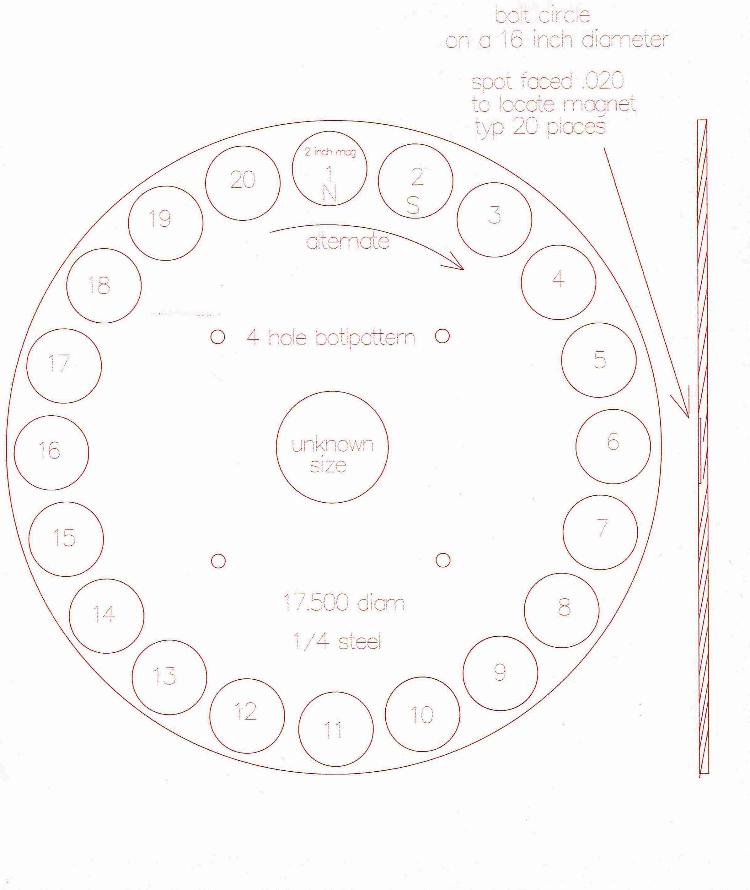

by Disaster Transport (kjehgahagan@yahoo.com) on Fri May 11th, 2007 at 02:20:08 PM MST
I will make this Monday with a hub Im picking up toniteDo you see any thing wrong with the design.Do you like the sspotface for accurate layous and securing the mags better. I havent purchased the 2 inchers yet...But check this out if you dont see a diagram just go check out my files here at the site.Later
