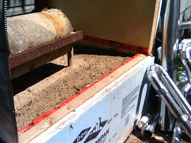

what lengh of copper for good heat transfer?
i ran out of time last year to finish my stove.
lots of desigh changes too.
http://www.otherpower.com/images/scimages/2793/outside_wood_stove_001_Small.jpg relocated the contraption next to the little shop i want to heat
http://www.otherpower.com/images/scimages/2793/outside_wood_stove_002_Small.jpg
i will run air duct all around the stove and  through the wall
i have a thermostat and blower ready to go.once the ducting is inplace i will put up the insulated walls and roof and fill the space with sand .
http://www.otherpower.com/images/scimages/2793/outside_wood_stove_003_Small.jpg
i would also like to run a hot water system to move the heat to my house next year.
i can't go any further (build walls and fill with sand ) untill i get the plumbing in place.
my question is what lengh of flexable copper pipe should i use to ensure a good transfer of heat?
also, if the copper pipe is installed (wrapped around the fire box) with out a fluid inside to help cool it, would it be damaged by the heat?

Well, I have built a few wood stoves in my time, so here is what I think.
First, it scares me alittle that the unit is so close to the siding on the building, but than I dont know what will be used between them, anyway, if you are planing on completely inclosing the stove, than I would reccomend a blower that would direct air from the floor area of your shop into the stove unit, and than just a different duct that would direct the hot air back into the shop at the highest area of the stove.
As far as using the copper pipe Im not sure why you would want to do that if you do not plan on have water in it?? I dont beleve you would ever get the stove hot enough to melt the copper, unless you had soder fitings, than of course that would not work.
I have built a wood stove that has 3/4 inch flex copper right in the fire box that coils around the 36 inch dia pipe line pipe that I used for the stove. I had a transfer pump that moved the water thru the coils, and into a heat exchanger in my shop. Of course you also need a expancion tank, and a pressure releif valve for this system, or it will go boom!!!! this unit used very little wood to keep the water hot. when I needed it.
I think for shop heat, you are on the right track, using just heated air with a blower, but make sure you eithe keep a air space, or some kind of nonflamable matl. between the wall of the building and the stove, I would hate to see you have to build a new shop. Ha.

the space between the siding and the stove is 16"
it will be filled with sand.
i believe the sand will dissipate the heat so that there is no risk of fire.
i spoke to the fire chief of my town he felt it would be alright.
i intend to place a temperature sensor through the wall . something like the ones they use when roasting meat.
it should give me the temperature of the sand next to the siding .
the air duct will loop around the stove . then be backfilled within the sand.
so i will have a stove inside a pile of sand 4'x6'x5'.
i idea is to create a thermal mass that will retain the heat even if the fire goes out.
i was thinking that here might be enough heat to run a hot water system to my house eventually.(next year)
that's about a 30 foot run. i have no time this year to put that in place(digging insulated trenches and what not) so i was simply going to wrap the copper pipe around the stove and place the ends were i could access them later.
still curious as to what lengh of pipe should be wrapped around the outside of the stove in order for it to pick up the heat .

the primary fire box is 16" dia.
so i could get 6 turns from a 25" roll .
if i use two such rolls i could run them parallel or in series.
 just like the electrical coils.
Re: home made outside wood stove (3.00 / 0) (#12)
by electrondady1 on Wed Jun 13th, 2007 at 09:25:07 PM MST
since i am just at the thinking stage on this one ,
it just occurred to me that two more coils could be placed around the secondary burn chamber.
four in all.
if i can run them in parallel  it would reduce the speed of fluid as it passed through the heating area allowing more time for it to acquire the energy.
thermodynamics! you gotta love it.

Since you seem to be flying by the seat of your pants here as it were. Maybe a setup where you have 2 independent coils with appropriate valving. Then you can either parallel or series the flow to get different results. Run in parallel when you have high heat or series when you have low heat. Just seems it would give you more control after it is installed. Maybe even several coils.
Do not mistake me for an expert. Just popped into my head as a way to expand the options after its installed.
Re: home made outside wood stove (3.00 / 0) (#14)
by electrondady1 on Thu Jun 14th, 2007 at 06:49:41 AM MST
tomw ,
i think your right, and i think thats the way i have to go.
4 independant coils that can be run in what ever configuration that is required.
add to that maybe, a speed control/flow control on the pump and it should give the options i need.
