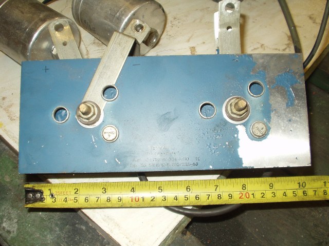

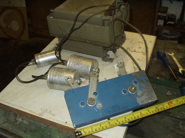

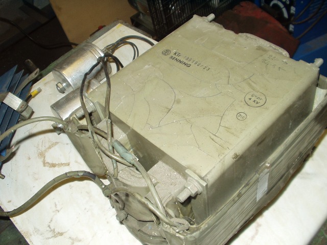

        It seems this isn`t going to be a straight forward job, never is with me anyway lol. I have contacted the seller of the generator and apparently these units were designed as dual output 110v or 220v but the British Army had a particular job in mind for them and had the 220v side disabled. If this is the case I may run at 220 and try and get a transformer to suit or a 48v charger but they are like hens teeth in these parts! I do have a large transformer from the battery charger of a 72v forklift the charger was single phase supply at 220v and it had 3 of these large 4kva transformers but only 2 are usable. I did a quick test on one of them today by hooking it up to 220v and with its own giant rectifier I was getting 84.5v dc with no load. I know the battery will clamp the voltage down but I suspect this is still to high, I don`t want to do the battery any harm. I have added a couple of pics of the transformer and bits for clarity.

Re: Need some help please with new diesel generato (3.00 / 0) (#6)
by Ungrounded Lightning Rod on Wed Jun 13, 2007 at 07:41:44 PM MST
I suspect you'd damage the rectifiers and/or transformer before the batteries.
Those transformers would be fine if you were running 72V of batteries.  But for 48V you'd need to tap their output winding at about 2/3 of the current output.

Re: Need some help please with new diesel generato (3.00 / 0) (#7)
by Flux on Thu Jun 14, 2007 at 12:29:20 AM MST
72v is high to run in the conventional way, you will need a fair bit of ballast resistance. You may be able to tap the winding or even regulate the alternator to lower than 220v.
If you decide to go with the inductor in the dc output then 72v should be close to what you want. You may need a bit of resistive ballast if inductance alone can't deal with it. Again reducing the 220v input voltage would be easier if the alternator is adjustable.
Don't worry about the batteries, they will not be the things that suffer as long as you don't run the charger beyond the gassing volts stage, they will clamp the voltage, you just need to keep the current within the limits of the individual parts ( transformer and rectifier).
