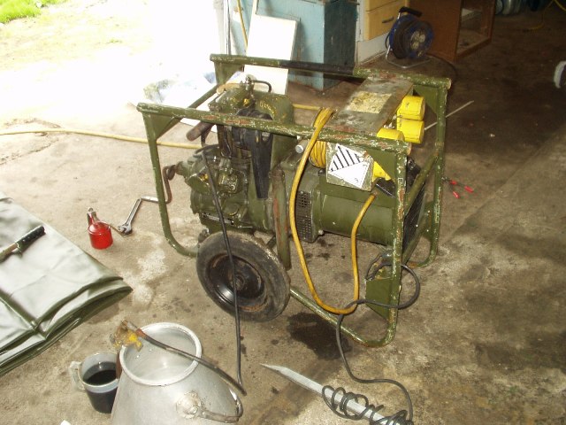

         I posted last week about a 110v 3.5 kva Lister Petter diesel generator (ex Army) I purchased from eBay, it has finally arrived! And I must say I am delighted with it. The hour meter has 83 hrs on it and it started on the first swing. This was an absolute bargain at £150 ($300 USD) plus shipping

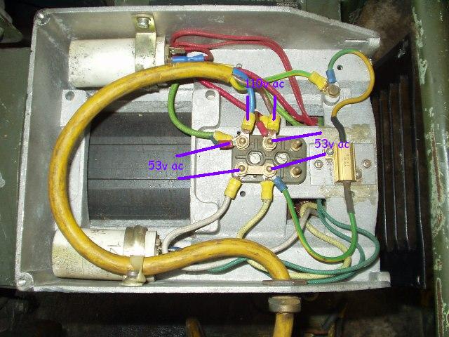

 I will post a more detail story soon but for now I need a little bit of help with the wiring please! The output is 110v or there about, I wish to charge a 48v battery bank with this, I was going to use a transformer but after doing a couple of tests I might have a better option. The pic below shows the connections from the alternator as setup for 110v ie 2 x 53v can I just put these 2 53v outputs to 2 bridge rectifiers and parallel the dc output 53 x 1.4= 74.2dc ? is it that simple?
 And finally for now if I link the green and red terminals the same as the white and yellow would I then get 220v? my thinking is that with a couple of switches I could choose 110v or 220v! could be very handy. I thought it better to ask the experts first rather than make the magic smoke!

Without detailed drawings of that alternator I would be reluctant to give advice.
It is set up at present for 110 centre tap and you could use 2 diodes to make a biphase rectifier with the negative coming from the centre tap and the positive from the common diode cathodes.
Whether you can split the windings and use 2 bridges depends on how the excitation is supplied and how the sensing voltage is measured. It may not be possible. I have even less idea whether it is possible to connect it for 220v just by looking at a few leads.

Having had a closer look at that picture I am almost convinced that it is a capacitor excited brushless machine with diodes on the rotor ( Nonaka ).
If I am right then you should be able to separate the 55v windings. There will be no connection from them to the exciting circuits that feed the capacitors. Don't mess with the capacitor windings or try to take load from them or interconnect them with the power winding. I see no way to connect it for 220v.
It will be highly sensitive to speed and for battery charging you may be able to control the output by adjusting the governor speeder spring. It will loose excitation below a critical speed so you may still need some resistive ballast.

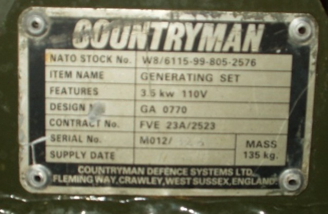

Hi guys
        I have added a pic of the id plate I doubt that it is any help though. From what I can figure out there seems to be 2 sets of windings ie 4 wires connected in series for 110v. I`m not really worried about getting 220v as I only want to use it as a standby charger. There are 2 capacitors that I presume are for exciting it and there is also a resistor between the series connection link and earth/chassis. The voltage is a little bit low instead of 110v it is 106v and 53v on the individual windings but I think it just needs the rpm tweaked up a little bit. I plan to give it a full service tomorrow so I will wait until I have change the fuel and air filter before I start tweaking at the gov.

by Flux on Tue Jun 19, 2007 at 12:51:55 AM MST
No the plate doesn't help but I am now absolutely convinced that it is a self excited brushless.
You are right that the 110v winding is split into 2 sections and the centre tap will be earthed ( via a resistor in this case)
You can separate the centre tap and use your 2 bridges, just ignore the resistor.
The exciting windings may be separate, each with a capacitor or they may be series connected to use a lower capacitor value. ( don't mess with the exciting windings)
Yes the low voltage will be caused by low engine speed but for battery charging you can set the speed as low as possible to reduce engine wear and reduce the resistive ballast required in series with the rectifiers. You will probably only be able to drop the speed by about 10% before you loose excitation.
