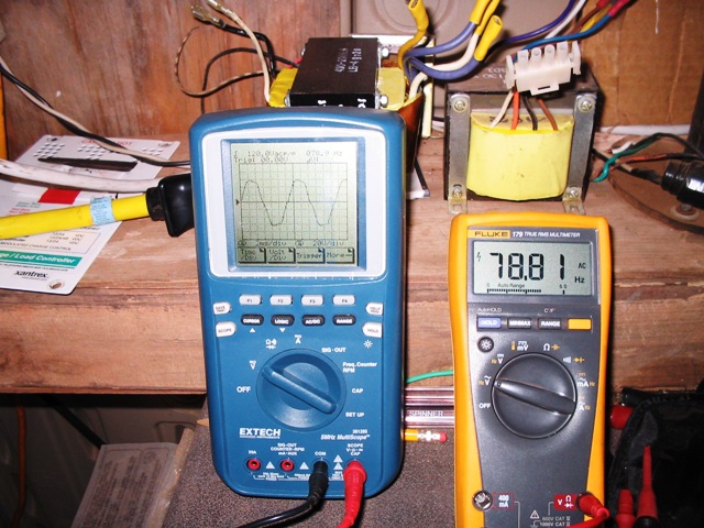

I used my digital camera to snap pics of all 3 electronic meters at the same time.
When graphed,it's easy to see the values are not as good as they should be.
The wattage ranged from 0.5 kW @ 60 Hz to about 3.3 kW @ 104 Hz.

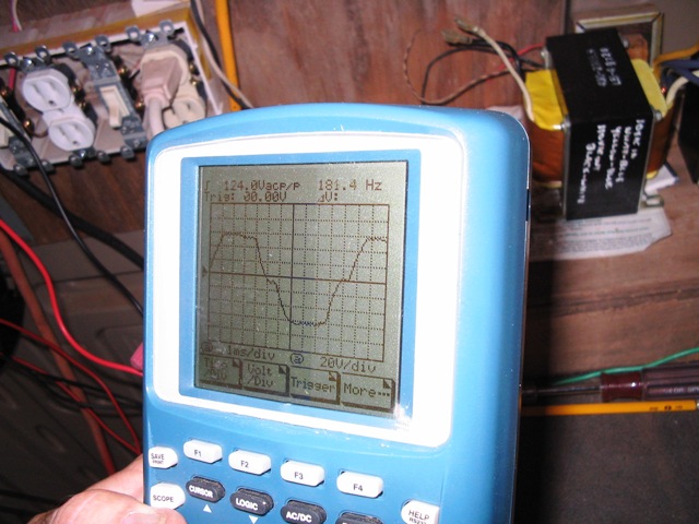

Next, I hooked up a scope to the genny. At about 70 Hz or less, I got a pretty good
sine wave.
Higher Hz chopped the top and made it look more like a PWM trace.
Any ideas what caused that?

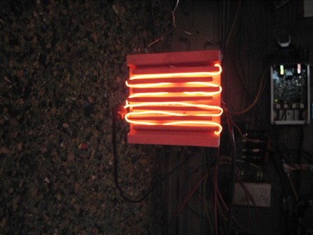

Here's a pic of the dump load.It needs to be resized.
The battery voltage was still higher than 48 volts after 2 hours.

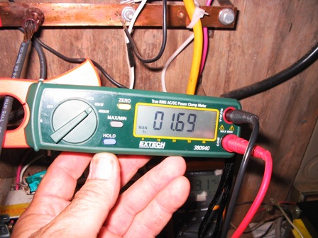

A pic of my new and soon to be returned multimeter. It's supposed to do ac&dc watts, ac&dc volts, amps, everything but ohms.
Most of the time, it does what IT wants. I only got a few good watt readings.
Expensive toy. Here, it is registering the dump load kW correctly.
I have a 50mV, 100 amp shunt. Can someone tell me how to use it with my Fluke DMM multimeter correctly?

I can't make any sense of your figures, I haven't much idea what you have or are trying to measure, but with the dump load chopping at 9kHz I think you have to think long and hard whether your results are meaningful.
Frequency meters are a pig in the presence of fast switching waveforms and need careful filtering. For power measurements again you probably need a lot of filtering and careful connection of leads particularly ground.
The modern digital meters are more inclined to lead you astray than their ancient analogue counterparts.  Measurements under these conditions is a bit of a specialist job and requires a bit of instinct that you acquire over time, what you see may not be what you get.
The red hot resistor is a good rms indicator, you are producing something useful.

phil;
Reading the shunt current is simply a matter of connecting the fluke across the shunt "meter" terminals and reading millivolts on whatever range you need [AC / DC]. The 100 amp, 50 mv shunt should drop [show] 1 millivolt [mv] for each 2 amps. So if it is passing 100 amps the meter will show 50 mv. The rest is just math. Check my math, cuz I suck at math.
Good luck.
sine wave.  ... Higher Hz chopped the top and made it look more like a PWM trace.
Yep.
Cutin was about 70 Hz.  Above that the battery was clamping the output voltage.  The generated voltage was still climbing with RPM but the observed output voltage is that minus the resistive drop of the current through the coil and wiring resistance.
The series resistance of the battery and the local wiring is very small and the diode voltage drop varies only a little with current, so the middle of your observed waveform just upstream of the diodes is almost completely flat-topped at the battery chemistry voltage plus two diode drops.

Yes that's right about the waveform. Up to cut in you will see the open circuit waveform of the alternator, usually fairly near a sine wave.
Beyond cut in the rectifier and the battery will chop the peak to near constant volts.
The dog leg as it crosses zero is caused by the commutation of the rectifiers on the other phases. That waveform is perfectly normal that is why I keep saying you can't use the normal sine wave based equations for these alternators on load.
