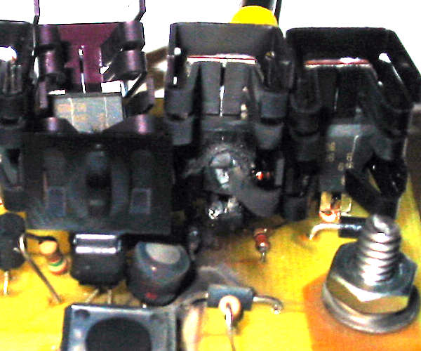

 I thought I was close but now I'm stumped!
I built and programmed my PWM dump load controller discussed in the other thread

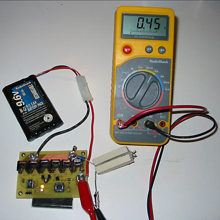

Here's a pic...
Right now it's programmed as a bang-bang controller with a soft start. (The PWM duty cycle ramps up over a two second period.) For testing purposes, I programmed the button push to do a ten second dump.
I did my initial testing and it worked very well at 10 and 20 volts with a 20 ohm load.
I installed it on my 24v battery bank bank with its .6 ohm load and pushed the button. It made it through about 1/4 of its ramp up and the LEDs went out... I pushed the button a few more times and eventually held it down; one of the FETs desoldered itself and started to sag on the board... I disconnected it and brought it back in.
I don't know how to test FETs but the one that sagged gave me a 1 voltage drop reading on its while the rest gave 1.3 volts which was about right...
BTW, I'm using stp60nf06's
http://www.st.com/stonline/products/literature/ds/7559/stp60nf06.pdf
I took a guess that the 5.5v 100 ma regulator was browning out and the causing the processor to continuously reset; the only thing I had of higher power (3 amps) was 5v, so I put that in. Again, it worked great with the lighter load inside. When I put it on my dump load, it didn't do anything... (and I didn't continuously hold down the dump button this time, I'm slow but I can learn!)
Again, I assume that the switching current is browning out the voltage regulator making  the processor continuously go into reset. Because the dump cycle didn't even appear to start I thought maybe I really do need a higher gate voltage.
I rewired the vreg for 10 volts and dead-bugged a level shifter and 5 volt regulator for the processor onto the board.
Again, worked great inside. On the mill, I was pleased to see the 10 second dump cycle start, run and finish and reached to put my hand on the FET heatsinks to see if they were warm and burned my finger. About a second later, smoke started leaking and another second later the board burst into flames.
Looking at it after I blew the fire out I saw that one FET desoldered itself, another melted off a pin and one exploded (and caught fire.)
I brought it inside, cut off the FETs and the digital section, voltage regulators and FET drivers still work! The only thing that was out of norm was the the 1n5819 I put in for a catch diode was conducting, acting something like a 4 volt zener... I think that's a casualty rather than a cause though, I can't see that package not breaking open if it was shorting the drains...
Here's the latest schematic -
I thought I was close but I'm stumped... any ideas?
- Ed.

Re: Confused by FET smoke and fire (3.00 / 0) (#31)
by elt on Sat Jul 28, 2007 at 04:28:28 PM MST
Hi Scott,
I've done some low current tests with the new board; like before it works fine at lower power. I've only got two FETs at the moment so I have to wait a little before I go for full power.
I've posted a new schematic and artwork in the original thread.
(http://www.fieldlines.com/comments/2007/7/5/172519/4320/19?mode=alone;showrate=1#19)
Here's a picture -
I free-handed the slots for my current sensor with a little chip breaker bit. It didn't come out as nice as I dreamed but I can fix that up. (I won't add the current sensor though until last...)
I did have some 50v 10uF caps that I put on the board and I had a high-pulse cap I threw on there for good measure...
The pic also shows my "FET-driver chip" before I soldered it in (the small bread board on the right side.) I did ask for some MCP1407-E/AT samples but they say the lead time is 2 weeks and I'm impatient.
I did pull the big caps out of a PC power supply; those are hefty leads! I'm going to have to drill some bigger holes beore I put them in. The two 680uF caps only measure 480uF and 500uF; would that be a sign that they are showing their age? I'm guessing that the that computer was on 7x24 for three years, about 25,000 hours... I appreciate the offer for the caps very much but I'm thinking these'll be okay.
You asked:
> How many will you be building?
Well, at least one more; I'm already building my second mill! I might make more if I can find a bucket of nice Mosfets because I think having one controller per battery is the ultimate way to go.
 - Ed.
