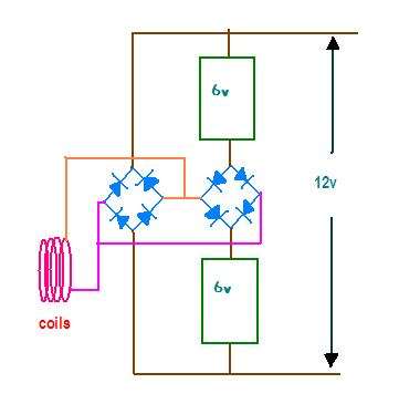

I like this idea a lot.  Is it possible to charge in parallel and drain in series simultaneously?
Re: 6 volt solution (3.00 / 0) (#5)
by TomW on Wed Jul 25th, 2007 at 06:46:33 PM MST
harriskevin;
Therein lies the rub. Not very simple to do, or maybe impossible.
Re: 6 volt solution (3.00 / 0) (#9)
by wooferhound (tim((NoSpamAt))wooferhound.com) on Thu Jul 26th, 2007 at 01:54:38 AM MST
Would This work ?
W o o f -={(
Re: 6 volt solution (3.00 / 0) (#11)
by snowcrow on Thu Jul 26th, 2007 at 07:21:56 AM MST
Hey Woof, I think it would work if he put one rectifier bridge between the batteries and the other bridge suppling the outside pole. It could work as long as he doesn't exceed the max. current of the rectifier bridge.
Re: 6 volt solution (3.00 / 0) (#13)
by SamoaPower on Thu Jul 26th, 2007 at 02:42:48 PM MST
Sorry Woofer, it won't work. The path shown will short the gererator, which is DC for the Ametek, by the way.

by snowcrow on Thu Jul 26th, 2007 at 08:19:17 PM MST
Will this work SamoaPower?
Re: 6 volt solution (3.00 / 0) (#16)
by s4w2099 (movlw0x13h@yahoo.com) on Thu Jul 26th, 2007 at 09:39:12 PM MST
(User Info) http://www.s4wsbox.com/
it does not look like that the genny will get shorted by this but remember that while being discharged the bridge will drop 1.4V so your nominal output would be 10.6 and thats almost shutdown for an inverter.
Dont think its a good idea. Someone correct me if I am wrong.
Re: 6 volt solution (3.00 / 0) (#17)
by SamoaPower on Thu Jul 26th, 2007 at 10:02:00 PM MST
Sorry snowcrow, this won't do it either. Although it will charge both batteries in parallel, there won't be 12 volts available since there is no current path between the batteries.
Where you show 12V will actually be the generator voltage less two diode drops when the wind blows and 0V otherwise. The batteries are effectively isolated for discharge.
