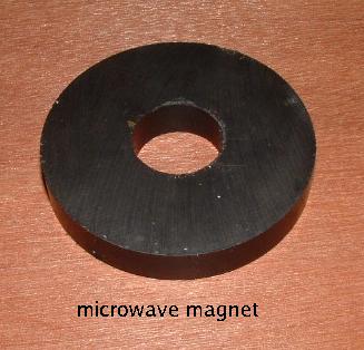

Microwave Oven Magnets
I have been removing these magnets from the old microwave ovens.
They are ceramic and very strong, with the alignment through the thickness. Speaker magnets are similar. This next picture is of a disassembled automotive alternator rotor with the coil removed.

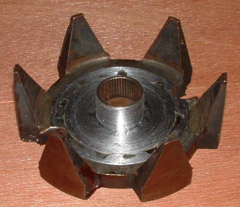

I have machined the center in order to hold the magnets.
The center is accurate to the magnet. This allows the unit to retain the true center and be balanced well.

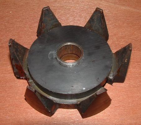

I used three similar magnets to fill the space between the end plates.

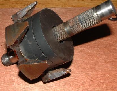

The last picture shows the assembled rotor
The rotor was placed back into the alternator. There is zero cogging in this unit. The first test at 1900 rpm produced 6.8 volts ac per phase at 2 amps. The total time to do this conversion was under three hours.

by oztules (oztules__at__bigpond.com) on Tue Jul 3rd, 2007 at 06:56:59 PM MST
Joseph,
I think the shaft provides a much better flux path for the magnets than the air gap between the claws... effectively short circuiting the flux from claw to claw, rather than jumping the air-gap.
With the original electromagnet, the shaft "became" the magnet and the return path for the flux was across the air-gaps. The shaft in your configuration now becomes the return path instead.
Solving this problem (with a magnetically inert shaft)will increase the flux density between the claws air-gap making it  the only decent flux return path.... increasing its effectivness markedly..... new shaft looks the ticket.

Do you mean, "6.8 volts ac at 2 amps between phases"? If you haven't rewind the stator yet, then thats not too bad. What do you get for a DC output?
Re: Easy Auto Alternator Conversion (3.00 / 0) (#4)
by WXYZCIENCE on Tue Jul 3rd, 2007 at 03:10:19 PM MST
snowcrow, only tested a single phase. I pulled the regulator and diode assembly out to get wild ac.

Separate each phase; rectify each phase individually then series the DC outputs. Not the best use of a 3 phase alt, but at least it will make some power.
If my numbers are right you should get:
6.8 ac x 1.41 = 9.61 DC per phase x 3 =  28,83 volts DC @ 1900 rpm. At half the speed you have slightly more than 14 volts. Not bad for cheap ceramics.
