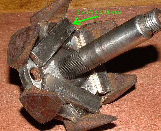

This unit is the second unit with neo magnets installed. Only one of the claws was machined to accept the magnets.
The six neos are placed into the claw in a star pile and glued in place with instant glue. I chose six to start because the thickness was the same as the hub that was machined off.
The second claw was left as an original.
The unit was assembled and the output was tested. At 1900 rpm the output across one phase was 6 volts ac at 10 amps. I am impressed. A full test with three phase into an star restive load was 180 watts. The shaft is still the original, with the threaded end fairly magnetic to a screwdriver. I was reading another thread about stacking magnets, so I am wondering if the addition of 6 more would increase the output any more. Also a nonmagnetic shaft is the next step. Anyway I will have to continue having way too much fun.
Joseph

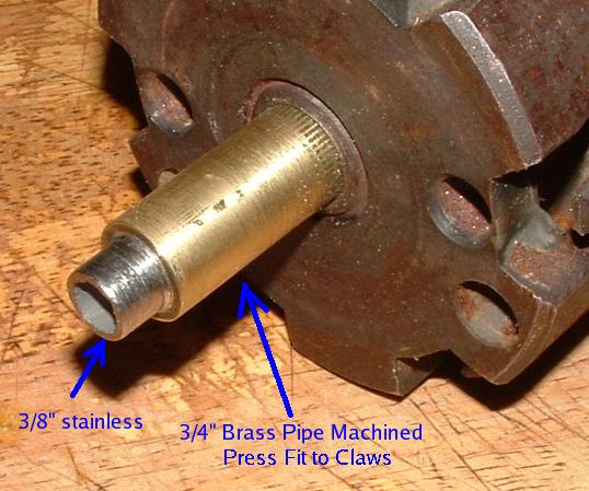

The nonmagnetic shaft is the answer! Here is a picture of the rotor with the brass and stainless steel shaft.
The increase in power is proof that the steel center shaft was shorting a major amount of the flux. The same test at 1900 rpm I am now getting into the star restive load over 300 watts. The only logical next step is to machine the other claw and add six more neos. I think that will give me a very simple and effective alternator conversion. I will probably do that in the next couple of days and post the results then.
Joseph.

Re: Nonmagnetic Shaft and Ceramics (3.00 / 0) (#13)
by WXYZCIENCE on Thu Jul 05, 2007 at 10:27:23 PM MST
although i'm joining the chorus of voices wondering how the s/steel shaft would be with your microwave magnets.
I machined a brass shaft for the first unit ( microwave over magnets ) and found very good results.
The load for both units was a star restive load made from nichrome wire 1ohm each.
The first test, 900 rpm with the brass shaft was 84 watts for ceramic. 8 amps 3.5vac
O.C.volts 4.65ac
Second test, 1900 rpm with the brass shaft was 225 watts for ceramics. 13 amps 5.78vac
O.C. volts 8.83ac
The first test, 900 rpm with the brass shaft was 141 watts for neos. 10.2 amps 4.64vac
O.C.volts 7.34ac
Second test, 1900 rpm with the brass shaft was 310 watts fror neos. 15.5 amps 7.1 vac
O.C. volts 13.95ac.
Joseph.

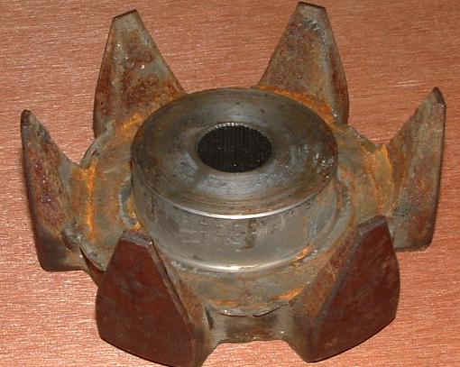

Great story. I was inspired and went over to my local appliance guy and he gave me two microwave magnets.  I have a GM Delco alternator. I got it apart, but I can't get the iron finger doodads off the shaft. How can I remove them?  Is there a special tool?
Jesus is coming. Try to look busy. GeeMac
Re: Easy Auto Part Two (3.00 / 0) (#18)
by WXYZCIENCE on Sat Jul 07, 2007 at 01:55:33 AM MST
GeeMac, I have several ways of removing the claws.
#1 Remove the nut fan and pulley assembly.
#2 Replace the nut.
#3 Place the rotor on a piece of pipe supported well to a solid base.
#4 With the aid of a 20 lb sledge hammer I hit the nut end very hard and square.
#5 Once off the shaft the claws come apart easily.
I leave the nut on so I can grind the end and still have a thread if I got to hit it a couple of times. One out of ten don't fair to well with this method.
The second method is to take the rotor to a shop with a big press. They can push the shaft out for you.
