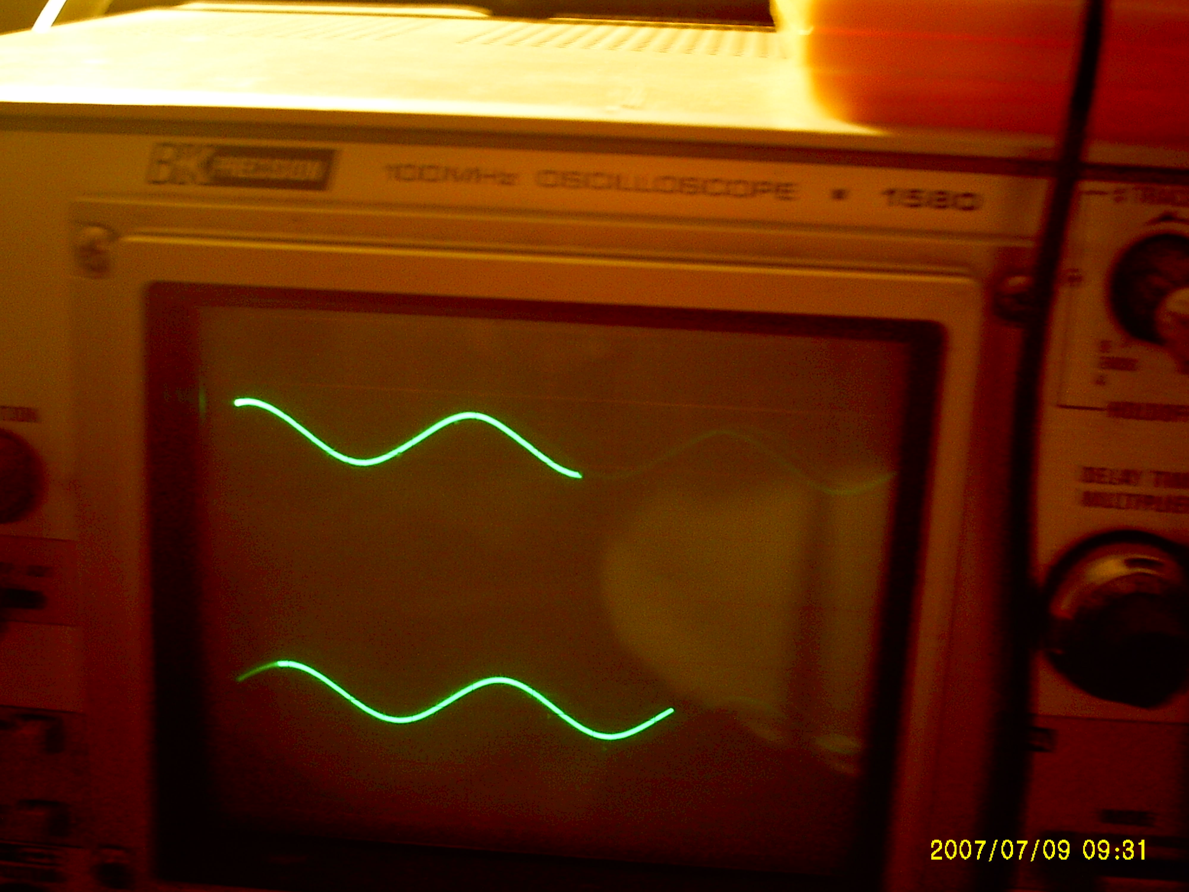

by cyplesma on Mon Jul 09, 2007 at 08:33:53 PM MST
ok, I'm going to say this, but let me show you some pics.
I have to take them first, but I was able to do some things late last friday, and did some testing sunday (had to visit some relatives saturday).
I actually have a perfect sine wave, I haven't been able to get the voltage up to 12 volts yet by turning it by hand and I can only get it going about 160 rpms by hand, but with the right blades (still need to make, I will be using pvc).
but let me grab my camera and see what I can show and tell.

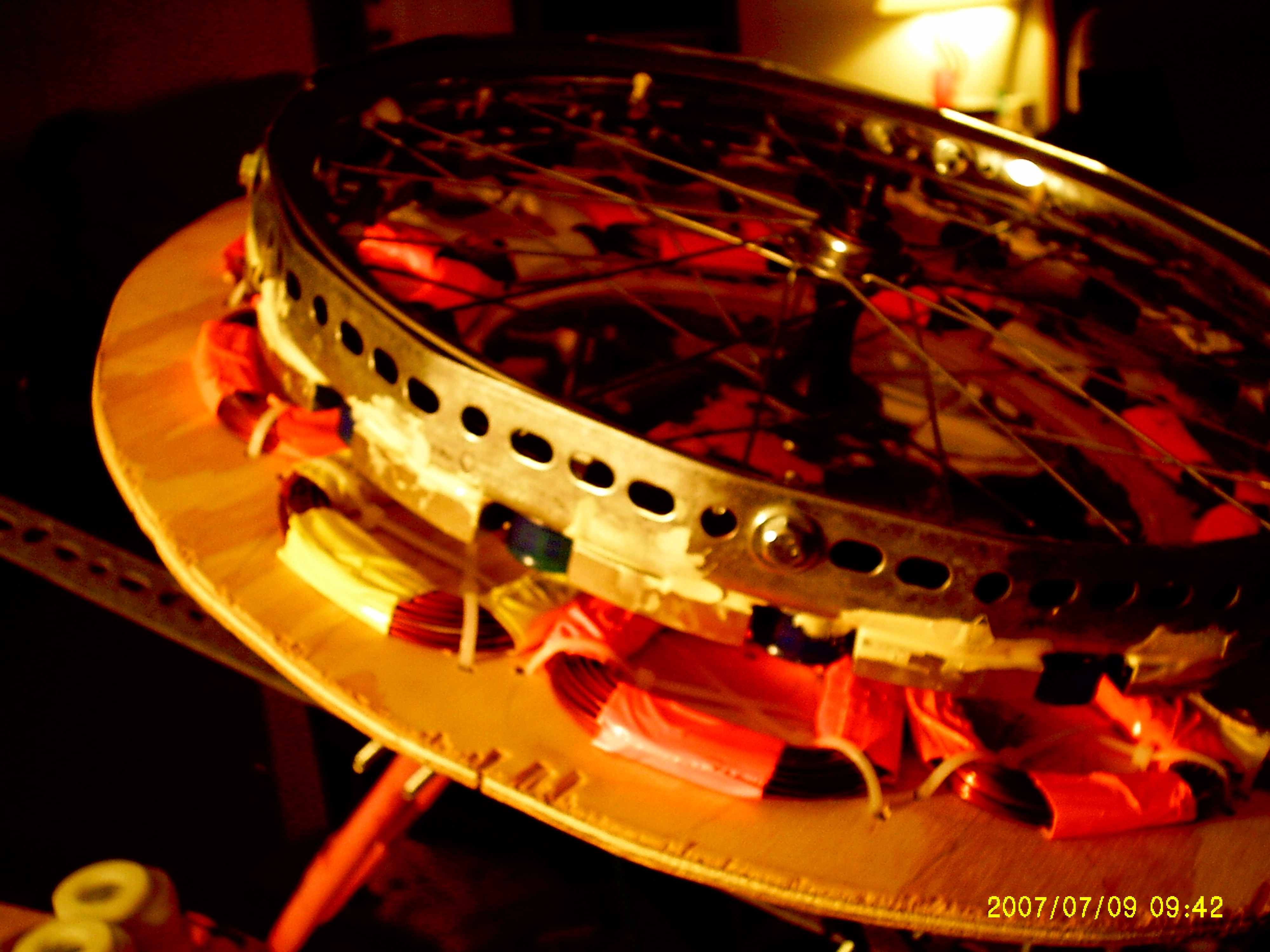

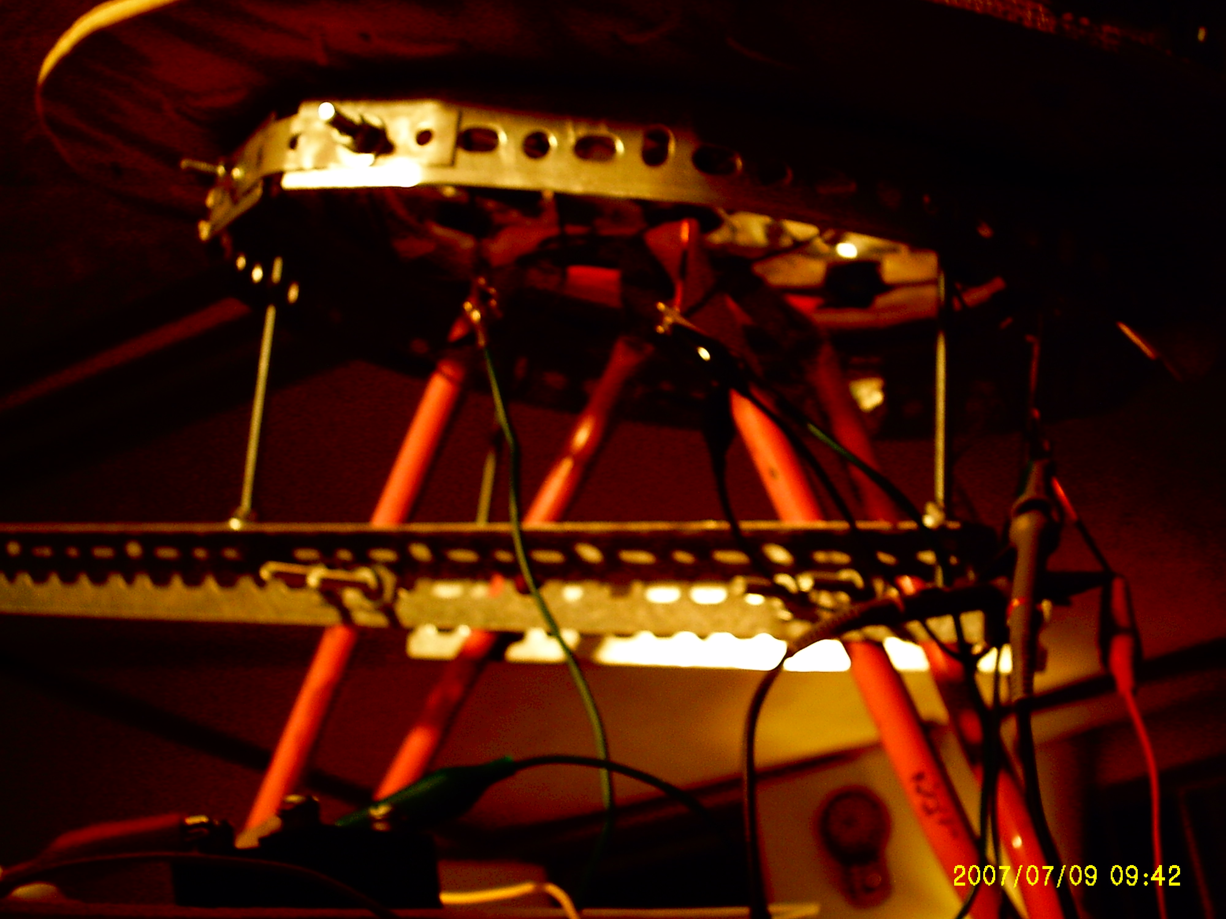

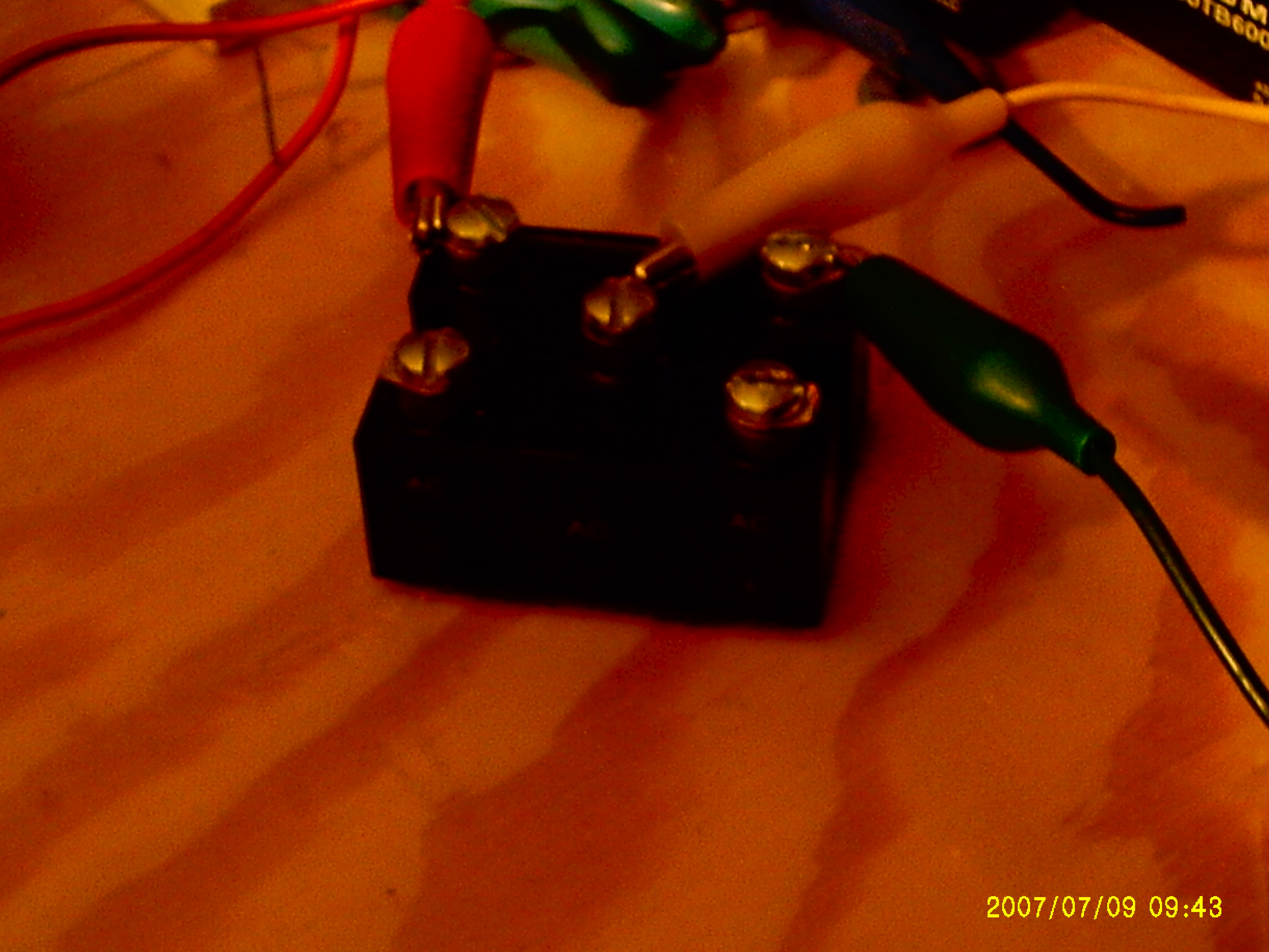

Re: rough cost of an axial flux generator? (3.00 / 0) (#5)
by cyplesma on Mon Jul 09, 2007 at 09:27:45 PM MST
now not many people (if any) will recommend you build a wind mill this way, but due to my materials on hand / budget in pocket.
I'm using a 20 inch bike frame to mount a 16 inch bike wheel.
I'm using small wedge neos I bought from wondermagnet a few years back. (yeaup almost about to put them to use)
I respoked the bike wheel
I screwed small slotted angle iron onto the bike wheel.
glued the magnets (16) onto the slotted angle iron
right now I have 12 coils (14# - 43 turns) tie strapped to a 1/4" piece of plywood
I mounted a piece of angle iron behind the plywood.
I am using a commercial grade 3phase diode rectifier to convert from 3 phase ac to dc
I'm hoping just the link shows and not the pic it's kinda big, having a little trouble with my digital camera. and the software to reduce the picture size.
http://www.otherpower.com/images/scimages/4112/rotormountedovercoil.jpg
here's a couple more
http://www.otherpower.com/images/scimages/4112/3phasediode.jpg
two unused connectors are for the DC out.
http://www.otherpower.com/images/scimages/4112/twophasesinewave.jpg
this is two of the three phases (currently star)
http://www.otherpower.com/images/scimages/4112/statormountingtestwirehookup.jpg
this is the mounting of the laminate behind the coils.
if the pics do show in this post I am sorry.
8 )
