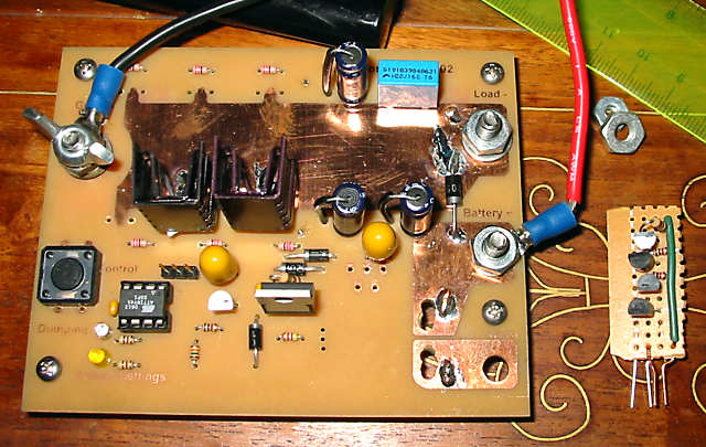

Hi all,
I'm programming the PWM dump load controller discussed in this thread (http://www.fieldlines.com/comments/2007/7/5/172519/4320/19#19)
Here's a picture of the (partially populated) board including my "FET driver chip" on the right ready for insertion -
All the parameters settings are field programmable via the single push button and yellow LED. (It's sort of like programming an X10 device - crude and a bit tedious, but doable.)
My dump load is abut C/5; my PWM runs about 3.8kHz and is programmable in 1% steps so I can load the battery from C/5 to C/500... my question is how long to I have to wait before I see a response in the battery voltage from a (small) change in the load? (How long do I wait between changes in the PWM duty cycle while I'm trying to maintain a particular voltage?)
Somewhere I thought I saw a post saying "a few milliseconds" but I can't find that any more. I Google'd and found lots about the load response in Lithium batteries (a few milliseconds, generally always less than 100ms) but nothing on the load response of lead acid batteries. If had access to an oscilloscope I'd just take a look but I don't...
Thank you,
- Ed.

by commanda on Thu Aug 02, 2007 at 09:21:38 PM MST
I did a similar control loop for a guy some years ago who was loading telco battery chargers.
The loop compares the instantaneous battery voltage with your reference, and increases or decreases the pwm one step at a time until the 2 voltages swap relative. So in effect it constantly hunts the other state, sort of like a flip-flop if you understand what I mean.
In your case, the sampling frequency has to be high enough so the load can ramp up and down in synch with changing charging current from your mill, without getting far enough behind that the instantaneous battery voltage rises far enough to hit the over-voltage cutouts on your inverters, as flux mentioned.
If it was me, I'd have a pot connected to an A-D input, and vary the sample time proportionally. Then you could fiddle it to suit your installation.

by elt on Fri Aug 03, 2007 at 05:39:43 AM MST
Hi Amanda,
That's a great idea!
The control loop timing is on a real time clock tick. I'll just store its period in the eeprom and set the parameter via the button and LED interface.
I don't think I'll have a problem running the control loop every 4 or 5 ms or perhaps every millisecond if I raise the system clock speed. (Am currently running at 2 MIPS, can go to 8 MIPS without needing an external crystal.)
I watch my 10 footer during gusts and it seems fairly responsive to changes in wind speed; it speeds up much faster than I would have guessed. I don't have a feel for how frequently the control loop needs to run but I think you're suggesting "pick a number and if the inverter trips, pick a smaller one." ... I can do that.
BTW - I did follow your suggestion for getting my two PCB layers aligned. While I haven't done a perfect job yet, I'm getting much better results than before.
Thanks again,
- Ed.

by commanda on Sat Aug 04, 2007 at 02:54:07 AM MST
Think of it this way. If the pwm is 8 bit, 0-255, and if it steps every 5mS, it would be capable of going from zero to full scale in 255 * 5mS, or 1.275 seconds. I would suggest this is several orders of magnitude greater than you need for a 10ft (?) blade.

by BigBreaker on Mon Aug 06, 2007 at 09:32:53 AM MST
As Amanda suggests, the open circuit voltage of the stator will be quite stable since the RPM will be relatively constant.  There's a lot of inertia to that rotor assembly.
The voltage and current characteristics into the battery - especially when driving a load - may be noisy though.  The stator has inductance that will try to drive a current through an otherwise high resistance - IE your transitioning FET.  Definitely worth a pot to tweak the sampling period.
