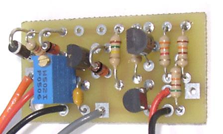

The Controller Circuit Unveiled
I guess it's ready.
The circuit design was intended for the smaller systems.
It is expected to fill the obvious gap between NO controller and a complicated or expensive controller.
The major design parameters were proper function, versatility, simplicity, ease in understanding, trouble shooting, and obtaining parts. And low cost.
The schematic is a virtual map of the circuit board.  Those who prefer a more standard format probably don't need this circuit.
Simple. The PCB was laid out to minimize risk of solder bridges. Nothing has more than 3 legs. Everything except the voltage divider output is On or Off.
Some mosfets will have a different pin configuration.  Be sure to get the G, S, and D in the proper holes.
Understanding the circuit, a crash course:
The rectifier diode protects the circuit against reverse polarity.
The Green LED shows the circuit is connected to the battery.
The Yellow LED shows the circuit is dumping excess power through the dump load, or the item connected to the LVD has power.
The first Zener diode and the pot is a voltage divider used to monitor the battery voltage.
The second Zener diode protects the ZM and 2N7000 mosfet from over voltage conditions.
When the voltage from the pot to the `ZM' is lower than 4.6V, the ZM grounds the 2N7000 gate and the remainder of the circuit is off.
When the voltage from the pot to the `ZM' is higher than 4.6V, the ZM is open and the 2N7000 gate has 5.1V. This turns on the rest of the circuit.
The P Channel mosfet sees low voltage at its gate and it turns on.  It supplies voltage to the power mosfet gate, turning it on.  The dump load is now on.
The capacitor provides enough delay in cycling to ensure the circuit does not go into excessive oscillation.
The extra steps (from N to P to N) provide a fast hard square switching, and allow for the use of numerous and various models of N channel power mosfets.
Meaning the expensive power mosfets need not be logic level or have an ultra low resistance (if the amps being dumped through it are low enough and the heat sink is large enough).  Even a lowly IRF530 can be added to supply 2A to another dump load.
Resistor RX determines the hysteresis.  The lower the ohms of RX, the tighter the hysteresis.
Some people or systems want a tighter hysteresis, like 0.06V.
Others desire a little more tolerance, like a hysteresis of 0.15V.
Using the circuit as a low voltage disconnect, a hysteresis of 0.6 or 0.8V is good for me.

I also see I did not identify the ZM as a ZM33064,
Or mention the trigger voltage is set by adjusting the blue pot.
Setting the pots center pin to ground at 2.7K gives close to 14V.

Used a 150w car heater on mine, picture of the controller in the case below..
Fungus - www.reenergy.co.uk
Re: Dump Control / LVD Circuit (3.00 / 0) (#6)
by ghurd on Fri Aug 24, 2007 at 05:03:10 PM MST
Hey Angus,
Options are nice.
Great photo!  Shows the open holes and parts without glare. It must have taken 100 tries.  Thanks!
It also shows the 10uF 16V tant cap included in the kit.  The earlier pics show a smaller cap for clarity.

by South Easter on Mon Nov 05, 2007 at 12:03:09 AM MST
Hi ghurd.  Firstly, thanks for all you have done on this!
Secondly, could you post a close up relatively hires photo of the assembled PCB? (similar to view of CtrlInHand.jpg.
It would be helpful to double check things during assembly.  Thanks!
South Easter -- http://windpower.org.za
Re: Dump Control / LVD Circuit (3.00 / 0) (#26)
by wooferhound on Mon Nov 05, 2007 at 01:56:18 AM MST
Yes, I agree
I got 2 kits from you
The first one I assembled incorrectly
And fixed it by resoldering a coupla componets
anytime you resolder something
it's not as good the second time
not to mention the heat
W o o f -={(
Re: Dump Control / LVD Circuit (3.00 / 0) (#27)
by ghurd on Mon Nov 05, 2007 at 07:09:17 AM MST
OK, close-up of a 12V version.
Don't go by the resistor colors, because I'm not sure what this one was for.
The bead cap C1 is not as large as the one in the kit.
South Easter, the 24V version has the extra Zener with the stripe on the left (near the pot), and remember to cut the trace on the rear between the empty holes.
