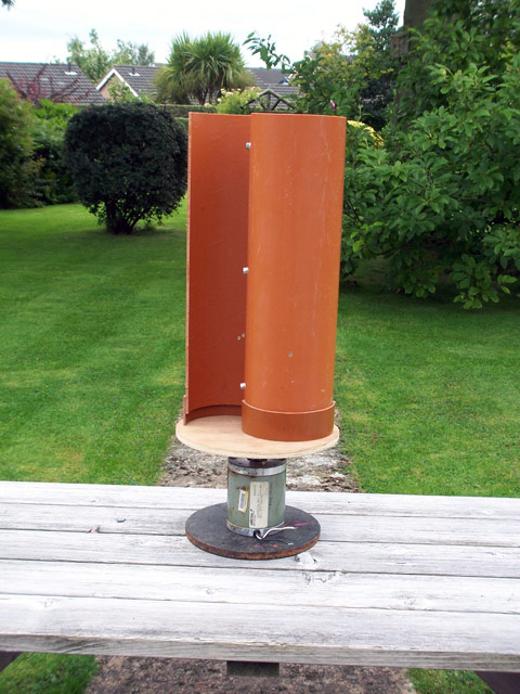

I tried a quick vertical axis project this weekend - with disappointing results....
I used 6" diameter P.V.C pipe halved and coupled to an Ametek 30v DC motor.
It seemed like a good idea in my head, but failed to spin in a 10mph wind, I guess it would work in a real gust, but never hit the 360 rpm cut in speed for 12 volts battery charging.
As TomW once suggested to me on the irc, VAWTS need to be big to get any real power out of them - He was right.
Oh well, I'll move on to the next project...

You can't direct drive an Ametek with a VAWT and get anything appreciable.  Speed up the Ametek with a belt or chain drive.

Your VAWT center shaft is destroying the air passing to the rear blade to add power to it.
Remove most of the shaft, to just not more than about 15 % eight, make another disk and firmly attach the upper ends of the VAWT.
To see what type of RPM multiplier you need, try to read the RPM and the wind velocity, divide the RPM by 2 to give the working RPM ( close enough), then see what is the generator Volts/RPM to calculate the multiplier gear.
Example: no load RPM = 110 RPM ; loaded RPM = 110 /2 = 55
Generator 15v /400 RPM =
Multiplier = 400 /55 = 7.27 :1 multiplier, make around 7 to 7.9 ratio.
Your wind mill looks ( estimating) like it is 3 inch X 12 inch or 36 square inches, then you have additional losses due to the loading of the opposite half side giving braking effects, plus the shaft destroying the wind passage to the opposite half.

  I wouldn't call it a failure, it's simply not matched up as well as it could be... don't throw it in the parts bin just yet!
  Here's one I've been playing around with using the ametek 38 volt motor...
  It's a small 2ft dia x 2ft tall turbine, kind of a quick build for testing purposes.  The ametek is driven by a cog belt 4 to 1 .  It does about 18 watts in a 15 mph wind right now although I think the motor needs just a little less re-drive.   Here is a closer shot of the mounting...
  This actually comes up to speed pretty fast but you can tell it's being held back by the motor considerably.  Opening the circuit it runs up considerably.
  There is a long bearing tube inside the mount tube that is held in place by 2 bolts clamping it inside the tube for now.  I purchased a couple aluminum cog gears and made some molds from them and cast them in plastic.  I plan to purchase a couple more small cogs to get a 3.5 and 3 to 1 redrive for experimenting.  Belts are cheap, the cogs are pretty pricey.

Wouldn't you need more than two "cups" on a VAWT considering that when both are perpendicular to the wind it's going to want to try to spin backwards.......
And I think I've read either here or elsewhere(maybe Ed's place?) that if you're only using two cups you need to make a stack with two more on top 90 degrees  apart thus that there's at least one cup pulling all the time.......

OK , two things. One: Try the twisted helix design instead of the straight blade.
Two: Ametek motors are not known for good output. They simply need too high of RPM.
The generator I use needs only 120 RPM to reach 12v. Makes a big difference.
Keep in mind VAWT generators turn slower than airplane type blades. The good news is that VAWT are more efficient than HAWT type.  In other words they turn more often.
