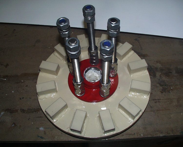

by sdscott on Fri Aug 31, 2007 at 06:12:07 AM MST
I have also focused on getting more air-flow around the stator and magnets to aid in cooling.  A couple of things I've done that I believe can assist is; Drill a 2-3inch hole in the center of the blade-hub to allow the oncoming wind to be 'sucked' into the alternator core, and expelled by the fan action of the magnet-rotors.  Also, don't pot the magnet rotors. Instead, use industrial adhesives to weld the magnets to the rotors.  This will provide more surface area for better cooling of the magnets and better fan-action for moving the injected air around the stator.
