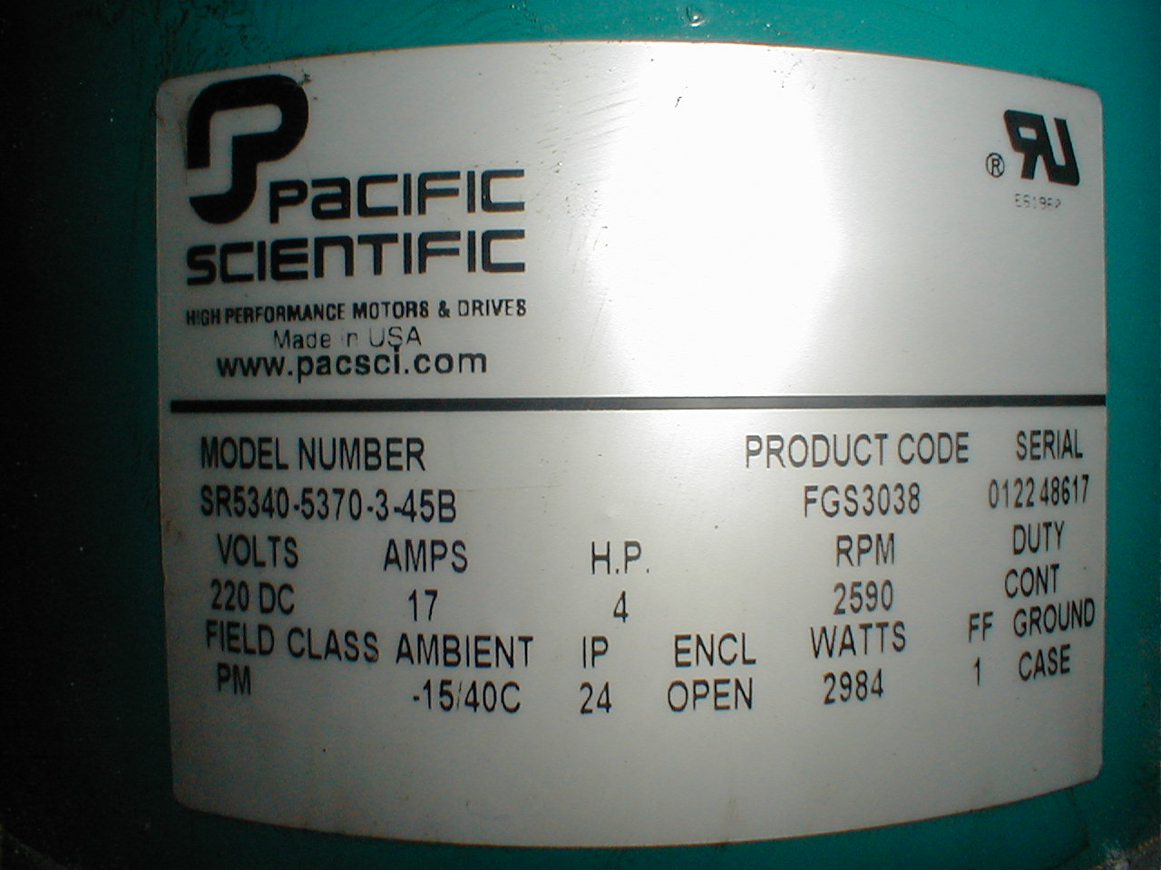

I got a 4 hp ish   2.984 kw permanent magnet treadmill motor. It is rated at 210v DC. It has a mechanical fan to circulate air and a huge metal hub mad of thick steel. The hub has a key-seat. I think I can just drill and tap it to attach blades right to it. I will post pics some time. I'm gonna need help making a good housing for it. It does need to be almost entirely weather proof right.
How will I manage such a beast of a motor? I have a solar grid tie that is made to work at 48v. anyone have an idea to regulate the voltage?
I was thinking I could add a battery bank that would be charged by it (a charge controller would be needed right) and have some kind of relay so that when the windmill is charging it the connection to the grid tie opens. When the wind dies down it would return to its normally closed. I would still need to have an additional normally open relay to the grid tie that would open when the voltage dropped to a certain point. Does any one have some bright ideas so that I wouldn't need to manually operate the windmill?
One last concern is too high of winds. How would you protect it from this?

I would think the first thing you need to ask yourself is why they just gave it to you.
 Maybe hook it up to a battery and see if it spins.
 Some treadmill motors have brush holder problems when worked hard.

I got it from the guy that manages the gym. He said the motor works fine it was the deck to the treadmill that broke. I am gonna do some spinning tonight to see what voltages I get. I might even be able to get an identical second motor.
