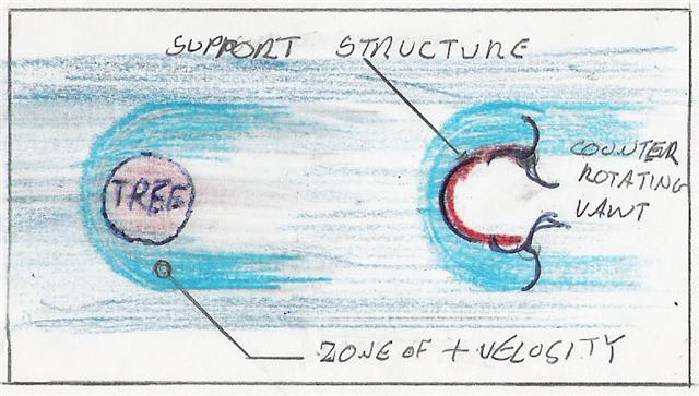

ok,
seems to be working!!
so this is what i have been able to take away from wdyasq's post
and the ensuing dialogue.
if i have gotten it wrong please feel free to revamp the drawing
i have no c.a.d. skills
it's pencils for me

Re: vawt to go (3.00 / 0) (#6)
by vawtman (vawtman(at)charter(dot)net) on Mon Aug 6th, 2007 at 04:46:02 PM MST
Hi Edaddy
 Nice coloring job
 My thoughts would  be to erase the tree or go above it.Trees can absorb alot of the winds energy.
 I look at a tree has wind turbine in my skewed mind.
 If your drawing has so presented would work the little airfoils(leaves and branches would remain silent has the wind eluded it.Instead it acts has an absorber like a turbine.
 Sometimes trees blow over and lose blades(leaves and branches)Like some know with turbines.
 Hope i didnt start a war again but seems common sense to me.
 A solid cylinder or airfoil would force the issue.
 My thoughts on the subject.
Re: vawt to go (3.00 / 0) (#7)
by windstuffnow (elenz(at)windstuffnow(dot)com) on Mon Aug 6th, 2007 at 05:31:55 PM MST
  It would work just fine as drawn.  The power that could be extracted from the turbines would extend to only the exposed blade area on each side of the tube.   It does help reduce the drag on the upwind side but also creates another problem as the blade tries to appear from behind the cup.   The pressure in front of the cup and around it is a high pressure zone where the back side and inside it are a low pressure zone.  As the "fresh" blade tries to pass the edge of the cup into the air there is a resistance because the air is also trying to flow to the low pressure side inside the cup and steals a bit of power from the exposed wing.
  As far as efficiency it would probably be a bit low but it work fine as drawn.
Have Fun! Windstuff Ed
Re: vawt to go (3.00 / 0) (#8)
by vawtman (vawtman(at)charter(dot)net) on Mon Aug 6th, 2007 at 06:29:12 PM MST
Hi Ed
 Has drawn he would have to plant trees all around it with airgaps to let the wind through has direction changed.
 Trees and turbines dont mix.My experience.Even with the vawt.
 I agree with the ducted turbines losses fighting no wind on the inside.
Re: vawt to go (3.00 / 0) (#9)
by windstuffnow (elenz(at)windstuffnow(dot)com) on Mon Aug 6th, 2007 at 09:09:34 PM MST
  I assumed the tree was just an example of the wind flowing around it... also, assuming that no one would mount a turbine behind a tree.
Re: vawt to go (3.00 / 0) (#13)
by whatsnext on Tue Aug 7th, 2007 at 08:35:15 AM MST
Wouldn't that just be a drag VAWT with a TSR<1 ? Let's have GeoM build one of these first.
Re: vawt to go (3.00 / 0) (#15)
by finnsawyer on Tue Aug 7th, 2007 at 08:49:09 AM MST
I wouldn't do it that way anyway.  I'd place a tube venturi type structure starting at the "zone of + velocity", otherwise known as the 90 degree line and channel the air to a HAWT.  Oh yeah.  You also replace the back half of the cylinder with a structure changing shape down to a tube.  This whole thing must be made to turn to track the wind.  It would be rather complicated.
GeoM
Re: vawt to go (3.00 / 0) (#14)
by finnsawyer on Tue Aug 7th, 2007 at 08:42:38 AM MST
Why don't you just put the blades around the tree, and replace the tree with a nice smooth cylinder.  I just know I'm going to exceed my allotted number of comments per day on this thread.
GeoM

Re: vawt to go (3.00 / 0) (#12)
by electrondady1 on Tue Aug 7th, 2007 at 07:15:03 AM MST
ok, ok,you buggers !lol
i just put the image of the tree in as a reference to finsawers observation of nature .
in my location,(in town) at the heights i can build to,(25')
it's quite common for the wind to shift back and forth about 45 degrees.
this is the very reason a vawt is  practical for me.
an add on that boosts power(a fairing) for one direction, interferes when the wind shifts.
 unless,
 you get the whole thing to pivot and face into the wind as pepa suggests.
we have now turned a very simple device into a complex one.
Re: vawt to go (3.00 / 0) (#19)
by electrondady1 on Wed Aug 8th, 2007 at 11:27:05 AM MST
" What one gets is a gradual drop in the air speed around the cylinder, which yields a peak power boost of 1.78 instead of four, which is still substantial."
i understand how there would be a gradation in the velocity . decreasing as one moves away from the cylinder.
lets drop the tree metaphor, as i have no intention of incorporating the effects of tree bark.
it is unclear as to how you arrived at a  1.78 boost factor
are you somehow averaging  the increase over radious 2xa??
i ask this as a way to determine an effective ratio of the cylinder dia.  ( fairing ) to the dia. of the vawt.
it has occured to me that the velosity of displaced air could be greater than 2x in close proximity to the cylinder surface .
Re: vawt to go (3.00 / 0) (#20)
by windstuffnow (elenz(at)windstuffnow(dot)com) on Wed Aug 8th, 2007 at 05:43:11 PM MST
  It almost sounds like an overunity conversation... There is no "boost" in power, the power through the turbine remains the same.  You can increase speed but you also loose torque.  I was caught up in the "boost" trap while experimenting with the Lenz turbine.  The center of the turbine contained a shaped core that would increase the wind speed around the wings.  It actually worked great using the venturi effect especially on the up wind side where the wing was traveling into the wind at the same speed the wind was comming in ( thus doubling the wind speed ).  Calculating it out using the double wind speed was pretty amazing on paper.  In reality my test showed the machine would spin quite a bit faster but with reduced torque.  After removing the center drum the turbine didn't spin as fast but the torque came up considerably.  Overall calculating the difference between the two showed about the same output in the same wind.   I opted for larger wings in the same dimension and ended up with a higher efficiency.
  Sorry, there are no free rides... the trick is to work on the conversion efficiency to boost output of the machine.
  The biggest problem in extracting energy from the wind is the overall efficiency.   That is to say, taking the wind and converting it to a useable form of electric in the shortest possible way.  We can make a turbine that will extract energy at the Betz limit, that's the easy part.  It boils down to our conversions that screw it all up.   We have wind but we want/need 110vAC at 60hz ( or DC appliances ).  So here is what we do to get it...  Wind to mechanical energy, mechanical to AC, AC to DC, store it in batteries, DC to AC through an inverter to power low efficient devices.  Each time we convert the energy to a different form there are losses.  It's actually quite amazing we get as much as we do in the end.  For instance... lets say there is 1000 watts of wind energy passing through the blades and we manage to get 60%, we filter it through an alternator that is 60% efficient, pass it down some wires - we'll call it 95%, convert it to dc and stuff in in some batteries 90% (if we're lucky ) then through an inverter that is 90% efficient.  What is left for our use.... 270 watts out of 1000.  When we pass it through some low efficient device were actually get to use 200 watts of all the work to get it there.
  We need a computer controlled wind oscillator that converts wind to 120v 60hz AC on demand and then stores the unused portion so we can waste it later.
Anything come to mind?
