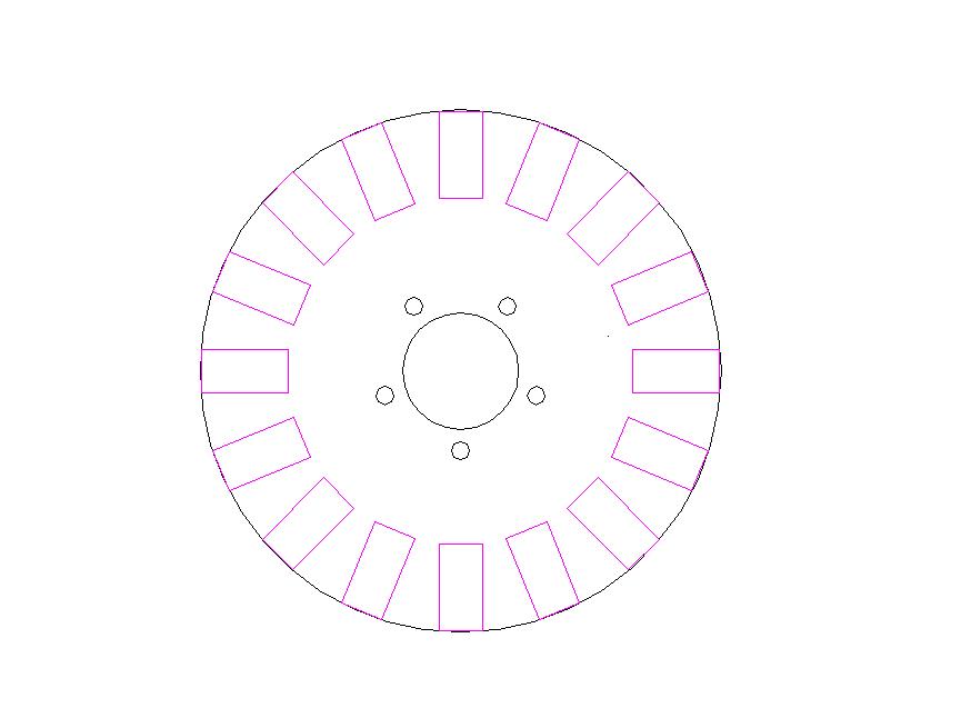

i have some discs and am wondering if theyd work
I have some steel discs... 16 inch diameter with a 3 inch hole.  looking at the ones our hosts sell, I am wondering if my discs would work with a dexter hub.
the center hole is 3 inches, a quarter inch larger than the ones they use in their projects.  I am stupid about how the parts all fit together, and am thinking that the size of the center hole doesn't matter as much as the "size" of the drilled holes... as long as the center hole is large enough to fit over the hub's center.
Or is there a 3 inch hub that I would have to use?
I may be able to get a lot of these discs.  they are about 1/4 inch thick, are rusty, but otherwise is great shape:
Diameter - 14 or 16 inches
Center Hole - 3 inches
Thickness - 1/4 inch

They'll work- just need to get the bolt spacing right. How many do you have? Gimme some ademdam discs! Rust doesnt matter.

Your assumption is correct. The center hole needs to fit over the center of the hub, and be smaller diameter than the bolt pattern which depending on the hub you buy can be 4x(?4 I think), 5x 4.5 (Ford) 5 x 5 (Chebby)- that means 5 holes in a 4.5 or 5.0 diameter.
So as long as the 3" fits over the center of the hub to fit against the face, you should be good to go. The rust - just hit it with a grinder or belt sander and knock it down. The hub I got from etrailer.com is 5x5 and is just 3" needed for the center hole.
I think you've struck gold although the larger diameter and powerful magnets for a good 10' machine (using 2"dia mags) - 1/4" is a little thin. They should be 3/8" or better. Using smaller magnets, say (12) 2x1x1/2, quarter inch plate should be fine.
I'm sure others can give examples of what they use.
Read Dan's chronicles of dual rotor design and manufacture here on the site. You will get to understand what is involved.
Here's an drawing that shows the pattern and the magnets on the outside.

IMO, the most difficult thing will be properly marking the holes. As Wind Pirate said those are the hole patterns. The six hole pattern actually has some advantages for a 3 blade mill.
IF all the center holes are indeed centered you build a good template that will have the  5 major hole patterns on one piece.
Standard hole patterns:
4 X 4"; 5 X 4.5"; 5 X 5"; 6 X 5.5"; 8 X 6.5"

Hole patterns shouldn't be a problem.  I can use a CAD program to make a full-sized mask and mark the holes for the 14 and 16 inch discs.  I have to check at work, but I believe that I can drill them with a drill press.

Well, I spoke too soon.  everything at my work is steel... except for these discs!  they are menganese!!!
sorry for any false hope there, guys.

It's most probably a steel alloy containing manganese for high shock, high stress, high abrasion applications.....check em' with a magnet.......
Re: steel discs different sizes (3.00 / 0) (#7)
by valterra on Tue Aug 07, 2007 at 02:37:54 PM MST
yep!  that's how I found out!  magnet no sticky.  ;)
