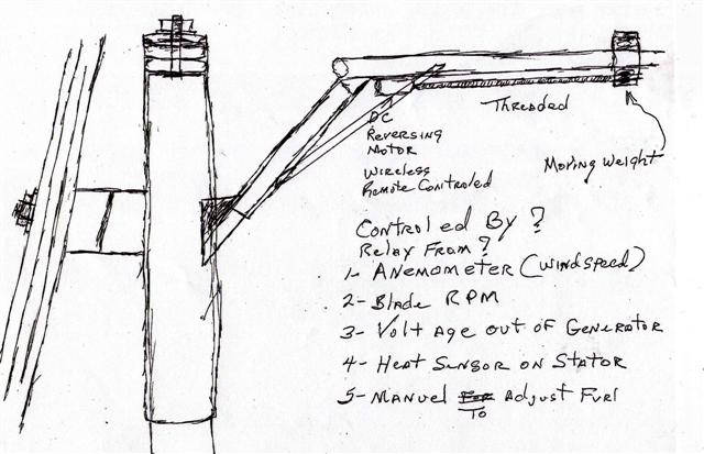

   Stator cooling. What problems would I have if I placed three large size wire coils around the outer edge of the stator that would be outside the range of the magnetic flux and in the area of the stator that is exposed to the wind.  Each of these coils would be tied to a phase of the stator winding by a relay that is controlled by a switch that would reset itself after it cooled down. The relay would tie the large coils into the system when the overload switch kicked out to add resistance to the coils of the stator and help dissipate the buildup of heat. Has anyone tried this? pepa

Pepa:
The solution is to avoid the overheating of the stator.
One of the solutions is to have a charge controller that allows MPPT in front of the battery bank. -- this implies that the wind mill will be allowed to produce higher RPM , therefore higher output voltage, for the charger to do the power conversion.
This way the generator my be in the 80 to 85 % power transfer, instead of the 45 to 53 % when charging a battery bank directly, where the bank behaves like a high power Zener ( clamping voltage) which forces a lot of generator internal dissipation.
Another way is to detect the charging current with certain value defined to a maximum of generator internal power dissipation.
Once this point is reached the tail setting is modified with a motor and screw to place the setting weight to a lower furling point.
Also, the most effective and for sure safe for many conditions, like high winds, is the use of a Torque Pitch Controlled Hub - the safest because the power harvested is defined by the load and if the load goes away, the RPM is automatically lowered ( under high or low wind velocities conditions).
I wonder when one of these experimenters is going to build one TORQUE PITCH CONTROLLER HUB.
No more generator overheating, no more over - RPM, controlled wind mill by just removing the load -- the TSR is set to 1 or even less.
In the past, I presented a centrifugal pitch controlled wind mill generating 11 kw, which is almost as good as the Torque Pitch Controlled Hub.
For the low watts ( around 1 - 2 kilowatts) the Hub can be simple.
Nando

   thanks Nando for the reply, i have been studying youe post on the 11 KW pitch control and i would like to build one when i have time. i posted a sliding tail weight for yaw control a while back that should work as well.

pepa, how about something this: A tail flap furling assist.  Just a solenoid, SCR, and a NTC thermistor in the stator as the SCR trigger. You would also need a rectifier bridge at the turbine, and isolated from the batteries for the solenoid to reset after the turbine slows and the stator cools down.  The flap on the tail is cut at a slight diagonal, with the top being larger that the bottom.  This will allow the wind force to lift the tail upward as well as into the furled position.  I know it's cured and I'm not most of an engineer, but it's my two cents worth!!
Blessings, Snow Crow

thats a good idea Snowcrow, i think it will work, pepa

Re: stator heat again (3.00 / 0) (#5)
by Dave B on Sat Sep 15th, 2007 at 11:37:31 AM MST
(User Info) http://www.madbbs.com/users/bruggelog
Pepa,
  It would work I'm sure but why not just decide what maximum continuous output you require and design for it from the start ? Now that so many 10 and 12 foot axial machines have been built using the common coils / magnet set-up it would seem to me that a maximum (continuous) output has pretty much been establised for that particular design ? The Dans could shed some light on this I'm sure. The dual rotor axial design is great, any stator will burn up if it's max. continuous output is exceeded.  That's the key (continuous). Because the wind speed varies so much we usually "see" peak outputs and from this call the machine a 1000 watt machine or a 2000 watt machine etc. etc. It's hard to accept that a "1000 watt" machine could possibly burn up at a continuous 1000 watts or even less. Just throwing numbers out there but I think that could be what's happening when we see some of these stator fatalities. Accept a safe continuous output by being fully furled at that level no matter what size machine. It's not a question of "if" your machine will be pushed to it's limits, it's when.  Dave B.
Re: stator heat again (3.00 / 0) (#17)
by pepa on Sat Sep 15th, 2007 at 08:18:10 PM MST
   thanks Dave for the reply, i have built several of the 10' machines and one 17' and followed Dans instructions to the letter. i started thinking about stater heat after his first burnout, and thank goodness, so far i have not had any problens with any of my mills. this was something i though might work and if i used some of the reclamed wire from my microwave coils, it would not be any extra cost involved. i live on the coast and have average winds of 7-10 mps, but a lot of strong storms with wind of 50-80 mps when a front comes through. i build for light wind and furl at 25 mps but have seen max wats at a full furl and it is a frighting thing to watch, if i built for high wind i would miss most of the wind. the 17' is flying at my hunting lodge and there is no one to shut it down when needed. just something to thank about, pepa.
Re: stator heat again (3.00 / 0) (#25)
by Dave B on Sun Sep 16th, 2007 at 06:52:59 PM MST
Pepa,
  I had my previous machine over speed which the main reason was I did not build in enough offset for safe furling. It is scarey for sure as I measured slightly over 800 RPM for my 12' diameter blade in 60+ MPH winds. If the furling is set to max. furl at what has been measured to be "peak" outputs in high winds then this can spell trouble when the sustained winds happen at these speeds. All the black magic seems to happen right there where wind seeking force, gyroscopic forces, centrifigal and centripital forces (sounds technical any way) can do some weird things if the furling is set a little "too hot" from ideal. I am no expert but my observation has been that if things aren't quite right which includes the load seen by the mill that higher RPM than wanted can happen at times for too long even when very nearly fully furled, burn out. I think the gravity furling tail is simple, effective and a brilliant design to dump wind and limit speed. We seem to get away with peak outputs in gusty winds but can see burn outs even below these peaks when the winds are constant long enough and fully furled is set too high. We all know those winds will happen. Like you know, until you've been there it's hard to appreciate how helpless you feel. Keep us posted of your designs, safe is good.  Dave B.
Re: stator heat again (3.00 / 0) (#16)
by jacquesm (j@ww.com- I run a whitelist, add 'stjoes' to msg) on Sat Sep 15th, 2007 at 06:13:20 PM MST
(User Info) http://www.greenbits.com/
hi there Pepa,
Sorry for hijacking your thread... It was not intentional but I got a little inflamed :) My bs meter went right into overdrive on seeing that PDF that you referred to, note that the date at the top (the date of the pdf) says 12/12/05 but that same tower shows a 1 ... 2 KW chinese (or somesuch) mill on the 22nd of January 2007.
Makes you wonder what happened in the meantime to the 'prototype'. It sure wasn't on that tower when nando posted his 'find'. I always get this feeling when I see windmill parts, towers, power curves that are fantastic but no actual windmills. My bs meter shoots right into the red :) Add to that a complete misinterpretation of the design as shown in the PDF and I'm pretty sure that all is not what it seems. The author of the PDF specifically mentions hydraulic control coming down
the tower in addition to power lines but you don't need hydraulic control for a torque controlled hub. Maybe they are for the brakes ? Then there is the case of the wrongly positioned pillow blocks, they're too close to the front, the first storm will take them blades included... But of course, that's only a drawing. I think that if you put together a PDF of a prototype windmill it should have at least one picture in it of the working windmill. This is a pdf about tower construction that as an afterthought mentions how you can weld together a VP hub. It does not show a working machine.
About your idea: it's pretty clever and I have not heard about it before or seen something like that (but that doesn't say much). You are basically dynamically changing the resistance of your coils on demand and air cooling those resistors at the same time.
The problem is the added complexity this adds, and the problems of having relays switching on and off on top of your tower are compounded by the effects of aging and the weather.
It's an interesting idea though, I would suggest a relay with a large hysteresis to avoid it switching on too fast again after switching off, better to keep the number of cycles down. And if you can use solid state relays, they age a lot better than mechanical ones.
And please post your experiences, even if it fails we'll all learn something new.
As for variable pitch, it is by far the best way to build a mill (I think) but I have yet to see a design that is simple enough and reliable enough to be executed by just anybody manufacturing or ordering a bunch of parts and bolting it together.
I'm sure that one day it will happen though, but I doubt it will be a 'budget' machine. VP has it's own unique set of problems (no matter what the control mechanism), and the control mechanisms are subject to all kinds of problems all by themselves.
best regards,
 Jacques.
www.greenbits.com
Re: stator heat again (3.00 / 0) (#18)
by pepa on Sat Sep 15th, 2007 at 08:44:34 PM MST
   hello Jacques, i like your greenbits site. i was thinking of using a motor over heat switch and it would only release the extra coils when the regular coils cooled down to a safe working temp. i have also been working on a pitch control design but nothing put togather yet, soon i hope. one uses a stepper motor in the hub to activate the pitch and one that uses the weight of the blades. to much thinking and not enough doing, pepa
Re: stator heat again (3.00 / 0) (#21)
by jacquesm (j@ww.com- I run a whitelist, add 'stjoes' to msg) on Sun Sep 16th, 2007 at 05:27:31 AM MST
make sure it fails 'safe', every component can break and you have to analyze the system with that component broken it should automatically feather the prop. I think that's the hard part in VP designs.
