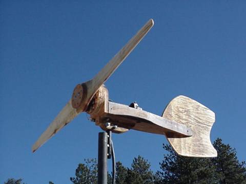

Re: Drag from Laminate on a Single Disc Axial (3.00 / 0) (#7)
by hiker on Tue Sep 18, 2007 at 12:18:48 AM MST
heres dans old wood axe...
might be a fun little gen to build...
  http://www.otherpower.com/woodax.html
