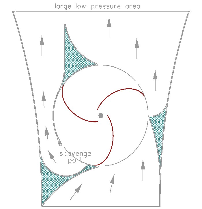

I'm new here and have been reading a lot. Recently I came across a new style of VAWT which looks promising for urban use. Has anyone else seen this before?

I think that shows a 7m X 5m obstruction - about the same area as a 7m HAWT.
From an online calculator:
188100.0 watts possible from 22.0 ft dia prop (380.0 sq ft) in 46 mph wind (density of 1.225000) 30096.0 watts output assuming generator is 80% efficient and Cp of 0.20
so - good luck ...

...and rather complicated for a vawt.
Re: Experimental VAWT (3.00 / 0) (#4)
by Ungrounded Lightning Rod on Thu Sep 20th, 2007 at 07:41:03 PM MST
They're using the rotating shroud to get rid of the losses on the upwind-moving side of the basic rotor.
If they get things balanced right it should get closer to Betz than a bare rotor, perhaps catching up with or even beating a HAWT of the same size.  They don't lose power to angular momentum left in the downwind stream.  But with a single-direction rotor and housing they have to get the wind to exert a standing torque on the housing to angular-momentum balance the torque on the rotor shaft, and that will probably produce drag.  They could compensate by stacking two rotors working in opposite directions with the shrouds tied together.  But then they'd need two alternators or gearing.
If they don't get things balanced right it won't face the wind.  B-)
