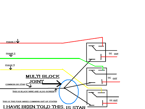

ive been doing a bit of testing with my mill.
 not verry happy with what im getting out in volts open circit.
 testing on a lathe .
  so before i do anything more i need it ask if i have the wires on the right way.
 cos if there not on the i will get nowhare.
 i understand the three phase set up with just three wires going to bridge rec.
  at 950 revs on lathe i only get 9volts.
  so if i do have the wiring correct then it looks like i need a jet turbine to boost the prop before i can charge a battery.

Re: i am dislectric . i need help (3.00 / 0) (#1)
by Flux on Thu Sep 20th, 2007 at 01:11:27 AM MST
I am sure your wiring is ok.
With only 4 ceramic magnets you are not going to get much out. I think you need to stop worrying about the connections and tell us more about the alternator.
Your connection drawing is correct for star.

 hi flux  now that i understand the wires are connected ok  i can try move on.

Re: i am dislectric . i need help (3.00 / 0) (#5)
by Flux on Mon Sep 24th, 2007 at 01:44:41 AM MST
I have had a look at your pictures and you have made a nice job, but I think the motor you started from is far too small ever to take your 6ft blades.
Changing the magnets to neo will increase the output quite a bit, but you would need to find curved neos. I doubt that any other shape magnets would make a great improvement.
Even after all this you may need to rewind to lower the cut in speed and the wire is ridiculously thin now, so the output would be too low to justify the effort.
If you want to stick to motor conversions then there is no point in looking at tiny motors, I doubt that anything under 1/2hp is worth playing with.
With neo and smaller blades you may get something from the present motor as long as cogging doesn't defeat you.
