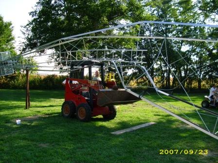

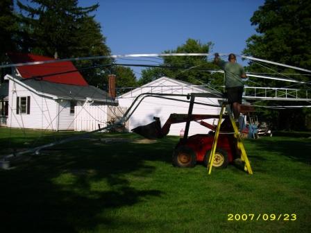

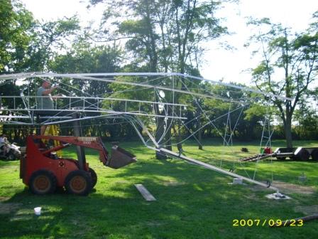

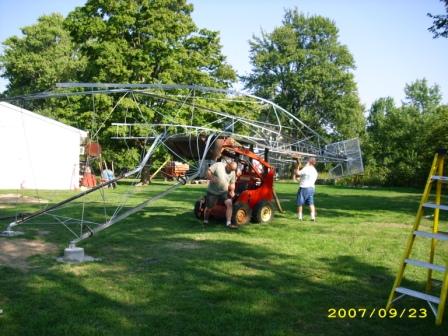

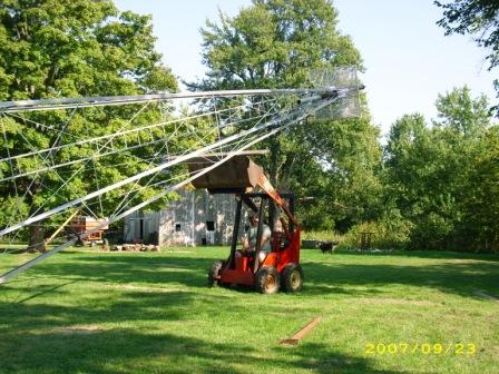

wrong way to raise a lattice tower
By methanolcat, Section Mechanical
Posted on Mon Sep 24th, 2007 at 01:13:42 AM MST
this is going to cause a minor setback
not much to say here as I think the pictures speak for themselves, lessen learned and a lot of reworking ahead of me.

I have seen larger towers than that raised with a bucket. How much weight did you have at the top?
Re: wrong way to raise a lattice tower (3.00 / 0) (#3)
by methanolcat (methanolcat (at)yahoo(dot)com) on Sun Sep 23rd, 2007 at 07:35:48 PM MST
not quite sure, aparantly too much for trying to raise it this way, I should have used the gin pole method, I can repair the top 20 foot section (minimal damage to it) I will redesign the bottom 20 foot though (not repairable) to accept a gin pole, not enough time this year to repair anything (too many irons in the fire already) but it will be ready for next spring.

If ever you would have got it up,probably it would have broken at the first wind.
And you could have been on that fancy platfform at the top.Your construction sucks.
Strange,you don't seem to have any rigid parts between the four poles.Those thin roundbars (or are it cables?)only can support pulling force.So your construction will collapse at the slightest force.
It can be ok to have the crosses in thin roundbar or cable(puling forces).But at least the horizontal reinforcements have to be rigid like the four mainbars.
But I think it's better to make all the reinforcement rigid like the mainbars.
cheers,
stonebrain

wow some of you really know how to bash a guy down, the others with sugestions and opions I greatly apreciate, that being said.
    The tower was made by me, only after lots of studying and measuring of many waterpumper towers in this area, all of which were lots bigger in height only and all using 3/32 2x2 angle for the uprights (mine using 1/8 which is 1/16 thicker roughly 50 percent stronger).
    I also used stronger horizontal and cross braces than any of the other towers I have seen, most if not all of these towers are 30 to 50 years of age and still standing, some even still have their windmills on top which range in diameter from 12 to 16 feet which in my opion would have pretty high solidity in high winds (these are all abanded, not in their furl position and I have seen some still turning)
    These towers were constructed in an upright position never intending to be tiltover towers (they all bolt together)
    My tower is all welded, but bolts together in 2 sections so I cannot assemble it the way the old waterpumpers were.
    My problem was the method of raising and I'll admit for the way I was doing it, I should have had more horizontal braces, especially towards the bottom.
    Hind site is 20/20
   I will redesign the lower section, with more braces, and it will be a tilt up using a gin pole and cables running from the gin pole to the top as well as mid and lower section of the tower for extra support.
    I am lucky I didn't get hurt and will take more precautions next time. Nothing on the tower did break it actually moved slower than molassis and we had time to get supourts under the top section before it was totally trashed. Kinda weird sitting there watching it slowly bending around me.

Looks like you had raised the bucket to the max,
Then were driving forward.
Kind of like how one might raise one end of a ladder, then walk up it until it ends up vertical.
The bend appears to be not just a weight bend (which would give a single bend in the center), but rather a compound bend, caused by the weight of the windmill PLUS the forward motion of the tractor.
You'd have probably gotten it up, if you had a better weight distribution at the point of contact of the bucket...  PLUS a better sliding action along the side of the tower.
For example, running a pair of continuous (some kind of good beveled lap joint) 2x8 or similar (flat), or rig a 2x6 (perpendicular), about 2/3 the length of the tower.  Maybe grease it up, and create a bigger slide on your bucket.
Of course, as mentioned, your tractor may not be real stable with the bucket extended to full height, and a lot of heavy steel overhead.

I think ya might have hit the nail on the head, I did notice some nasty gouge marks on the tower where it bent, and the leading edge of the bucket is rather sharp, I did have a hard time getting it to slide and the bucket was almost all the way up, the front wheels started to raise a few inches a few times and then all of a sudden the bucket would slide.
      Makes alot more since now that you mention it that way. I'm not the best operator in that lil cat anyhow, kinda jerky which I'm sure didn't help matters much.
     Maybe this post will help others from making similar, possibly even fatal mistakes, thats why I posted it in the first place.

          I've used the gin-pole method countless times on a 48 foot and 58 foot lattice towers.One cable hooked at the top and two at midpoint, spend some time adjusting the cables so they share equal loads and the tower will raise and lower with ease.
Re: wrong way to raise a lattice tower (3.00 / 0) (#27)
by methanolcat (methanolcat (at)yahoo(dot)com) on Tue Sep 25th, 2007 at 04:13:50 PM MST
thanks shadow, thats what I'm fixing to do when I try the next raise. Once I get it raised I never intend to lower it again unless I move (which I don't intend to do either).
Re: wrong way to raise a lattice tower (3.00 / 0) (#22)
by tecker on Tue Sep 25th, 2007 at 01:44:32 AM MST
This was probably not a bad thing .The tower needs  horizontal support every 10 feet .
you need cross braces of the same angle you used for the uprights . The skid loader can't do the job and a cable from the top has the best lift angle . But the tower is under a lot of stress at the point where it buckeled .Take note and thank the powers that be for saving your life.
