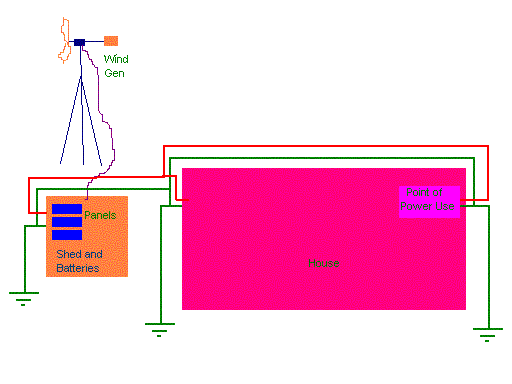

want to use 3 ground rods to help carry some of the Current
I have everything now to put up my Renewable Energy System and use some power.
 200 watt wind genny
 4 solar panels equaling 55 watts
 New Car Battery (I know, wrong battery)
 enough wire to get the power where I need it
 No Charge controller yet (Hey Ghurd)
I will be using about 5 amps or so in my computer area to run the modem, a small TV and a 12 volt CFL, probably more later. So I'm about to run the wire from the battery to my computer area which is a little less than 100 feet. The battery will be in a shed about 20 feet from the house. I already have a 12ga wire with ground buried going to the house. I plan on running the same 12ga wire around the house to my computer area like in this diagram . . .
The 12ga wire that I'm using is 3 conductors: 1 black, 1 white, one bare copper ground. I want to use the Bare Copper Ground wire as my Negative wire which is represented as the green conductor in the above diagram. I want to use Both of the other conductors Black & White combined as my positive conductors represented as the red conductor in the diagram. This would make a 12ga ground and an 8ga Positive wire.
Now I'm getting to my question. I want to use multiple Grounds on the Negative wire to help make up for the smaller gauge wire that I'm using for the ground. This would be using the grounds to help carry some of the current. But I've heard several times from the users of this forum that multiple grounds in RE systems are a bad idea for some reason like voltage differentials or ground loops or something like that. So is it OK to wire my system as described and shown in the Drawing ?

Grounds on a DC circuit will do nothing. Check between your distant ground rods with an ohmmeter. But if you have differing materials for ground rods you might get an Earth battery!

As stated earlier.... you get no effective ground return path for current at 12vdc between the ground rods.
Your Bare copper Ground wire would be carrying the entire load as single #12 conductor. (5amps @ 12v = 60watts) The Ground resistance between the two ground rods would be approx. 1Kohm per meter or 30Kohms... effectively carrying no load. I had this exact same setup to a remote 110v generator shed but there was a separate bare copper line laid in the ditch with the romex cable that carried part of the load.
My calcs show a loss of 8 watts with a 60 watt load.
12ga = .0016 ohms per foot 100ft = .16 ohms
load 5amps 12 volts = 60 watts
  1. volts / 5amps = 2.4 ohms "effective load"
  2. ft (both directions) X .0016 ohms per foot = .32 ohms
.32 ohms X 5amps= 1.6volts dropped = (1.6V X 5A) = 8Watts.
So it wouldn't get hot and you have 255 watt source capacity... my only concern would be the voltage drop. Not sure how the TV, Modem, etc would operate at lower voltage.

I got taken to school on grounds when I had to get my RE system by the local electrical inspector. Here's the way it's supposed to be wired: Everything is supposed to be grounded, solar panels, shed, tower, and house. The grounds are supposed to be tied to DC- and 110V neutral, but only in ONE location.
 I don't know what you're trying gain having the positive conductor larger than the negative, the current will still be limited to a 12ga wire, DC needs to flow equally between the conductors and as others have mentioned, you can't use the ground as a return path.

The ground between the ground rods will have too high a resistance to carry any significant power in your low-voltage DC system.
However, if (WHEN) lightning strikes ground nearby (unless you REALLY luck out and it strikes right on the electrical midline between your ground rods - every time) your negative DC conductor WILL carry a LOT of lightning current.
This will probably melt the wire, as well as destroying all your electronics.
If you have any sharp bends in the path, the lightning will jump out of the wire just short of the bend and back in just past it.  This will drop enough energy into the wire where the ends of the arc land that it will explode into a ball of copper vapor and plasma, which will then condense as molten copper on nearby flammible surfaces, igniting them.
This stuff about tying neutral to ground at only ONE point is very important.  Especially when you have such a nice lightning rod as a windmill tower carefully situated with the high end above all surrounding obstructions - and thus far above their "cone of protection", providing a nice roost for the thunderbird right at one end of your wiring.  B-)

First, some National Electrical Code terms. - "Equipment Grounding Conductor". This is the Bare wire and should be tied to every exposed metal part of the system, tower, solar panel frames, etc. Normally, it never carries any current.
You didn't show any fuses or disconnecting switches. I would suggest a fuse and optionally a switch each for the batteries, wind generator and solar panels.  I would then bring them together in your shed as your positive bus in some small metal box. This will protect your system if there is a short in one of the dc sources. Another fuse or fuses can run from this to the load or loads you serve.
Next is the "Grounded Conductor". This is the negative wire of the 2 insulated wires (white). It is a current carrying conductor. It becomes grounded by a single point bond somewhere between the source of generation and the first main disconnect. The most logical place is in the shed in this "panel". This panel can be a neat box with switches and fuses or inline fuses and wirenuts. The switches are just a convenient optional disconnect method. You need to run a wire from your negative line to the ground of the panel. It can be as simple as a wirenut connection or a grounding terminal strip. of This bus is then tied to a ground rod (or rods) by the "Grounding Electrode Conductor". This too can be bare. Iy is also tied to the bare "Equipment Grounding Conductor". The negative (white wire) leaving this box is the grounded conductor. It is never to be tied to ground beyond this point. You can add ground rods to the equipment grounding conductor if you wish. You might put one at the wind tower or house to help against lightning.
