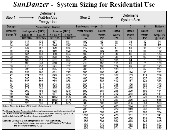

Lookin good out there volvo,  I was just reading up on DC fridges for remote locations.  An electric fridge will certainly add to your generation and storage needs.  Below is an array and battery sizing chart for one manufacturer of efficient DC types.  Note the size of the Fridges and Freezers.  I imagine that after running the power through an inverter for a much larger AC type, where efficiency is not necessarily the number one priority, will result in the need for significant additional resources.  Rich

I think I'll be OK. We've got 800Ahr of battery @ 24V. I can't remember the last time I was over 15% into it. We've been doing fine on our previous arrays and just added 680W. Sun-hours here are 5, even in winter, with a fixed array. I'll do better than that with tracking.
The 120V fridges I've been considering are on the order of 1.2KWhr/day. I've just added three to four times that in generating capacity. Even if inverter and battery losses were about 50% (which they're not), I'd still be making enough power on solar for one of these $500 Kenmore fridges, providing we don't get three or four cloudy days in a row.
