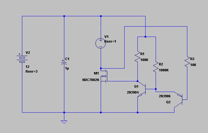

Posted on Wed Sep 5th, 2007 at 11:10:14 AM MST
Preventing reverse current with no voltage drop
I would like to be able to measure my generator output voltage, even when it is below the battery voltage (at the moment, the only way to do this is to disconnect the battery).  I could add a diode, but that means a voltage drop and power loss.
I found the following circuit - can anyone comment on whether its will work, is worth building, or if better components could be used?

Thanks for comments.  Its a PM 3 phase generator.  The rectifiers are on top of the pole, and getting extra wires down would be a hassle.
I covered the option of extra diodes in my post - this loses some voltage and power.
Such a circuit would allow data logging of generator (rectified) voltage and battery voltage separately.  Together with wind speed this would be useful.
Comments on the circuit itself would be much appreciated!

Yes you do have a problem if the rectifier is up the tower.
A series schottky diode would not cost you anything in real terms. There will be a power loss in it but you will not notice it as the slight increase in prop speed will probably bring you away from stall and there will be no detectable loss by including it.
I am not sure about your circuit, I can't read it without saving the drawing in  something to enlarge it. I don't think it will be completely satisfactory. I think you need an op amp or comparator to be precise enough to detect the turn on point.
For mosfets to have an on resistance much lower than a schottky you need lots of them in parallel. Ok for a tiny machine but if you are looking at lots of amps then you need several mosfets even if you choose those with very low rds on values.
Unless you are using some form of mppt to keep the prop on the peak of the curve, line loss and a bit of diode loss is something you have to accept. You can remove it at great cost but you can't extract the power that would otherwise be lost as you stall the prop and drop its aerodynamic efficiency more than you can gain on the electrical side.

Since you have not given enough information, the only thing to do is to wild-guess what you have.
You have a generator up the tower with rectifiers and just the DC power is brought down and connected directly to the battery bank.
Since you do not WANT to disconnect the battery, then you have a problem when wanting to read the generated voltage.
A solution is to have a relay between the DC power coming down and the battery, read the voltage and when the voltage is just above battery voltage, close the relay contacts to charge the battery bank.
The logical way is to measure the voltage before the diodes, to have the battery isolation needed to determine the generator voltage when below the battery voltage level.
The alternate way is to have the generator in a test bench with capabilities to drive the generator at known RPM to get the voltage generated or the Volt/RPM factor and from there, the only thing needed is to have a small circuit to measure the RPM which give the Voltage output at any RPM level.
The circuit you have is a Flip-flop,and does not do what you want and since I see that is not practical for your needs I will not spend the time to explain how it works.

Nando, all your guesses are spot on.  I ran a simulation of the circuit using LTSpice/Switcher CAD III (the diagram is a screen shot of that), and it seemed to work as intended.  Not sure how to make diagram clearer - its all very clear when I view this post.  Any suggestions welcome.
But it sounds like a schottky diode is the way to go?  Or maybe germanium?  Flux, can you recommend a specific part number?
Is there any reason not to rectify (at the top of the pole) using schottky diodes?
I did bench testing, and found a KBPC3510 rectifier gave DC at 2.4V below the AC voltage.  A SB356 gave DC at 1.3V below. I was surprised at that difference!
I work at 24V, so that kind of drop means there is a lot (ok, some) of the time when the generator could be delivering current but isn't due the voltage drop across the diodes.

Your voltages indicated are undefined and the circuit itself is not well determined.
for one include the Fet intrinsic parasitic diode and you will see the differences and limitations.
The V1 voltage will be inserted into the circuit when its voltage is within V2 less 0.6 volts, also the 2N3906 Base Emitter junction is in reverse mode allowing the breakdown ( Zener voltage of it ) flow current causing transistors behavior to be affected.
Then if the V2 voltage is greater by 0.8 volts than the V1 voltage, the Fet intrinsic diode to be turned ON ( reverse mode operation)- which may give you problems if V2 does increase radically.
If you want and really need to measure the voltage at any time, then another circuit is needed, like to be installed up the tower and brought down either with wires or wireless device to send the data.
Proper data taken is BEST to define the generator Volt/RPM and RPM measurements will give you the generated voltage even under any load and if you have the generator internal resistance, then you may be able to calculate the stator watts dissipation at any instant.
One needs to think in practical terms the parameters and the design of a circuit to see if it is applicable for one needs.

No one likes to talk about the reverse leakage of Schottky diodes that can make a reading incorrect unless a load is placed on it.

 I never trust the reading of a bridge rectifier either into a digital meter without a nominal load of a few mA. some of the waveforms into a 10M ohm meter are very strange indeed.
To measure the dv volts below cut in with a schottky in series I would load the meter with about 4.7k or use a good old analogue meter.
