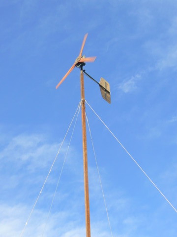

Last couple weeks have been busy/interesting.  We've done lots of metal work, made a few stators (boring stuff sort of) so no pics of that.  Rich's 7' wind turbine (pictured above) has been wonderful.  He hooked up a C40 controller to a couple 300 Watt resistors sized to draw about 40 amps.  The system works great.  He's lived for years now off less than 100 watts of PV solar.  He occasionally watches a movie (usually on his lap top), runs a couple light bulbs, and a stereo.  The wind turbine has really changed things at his house.

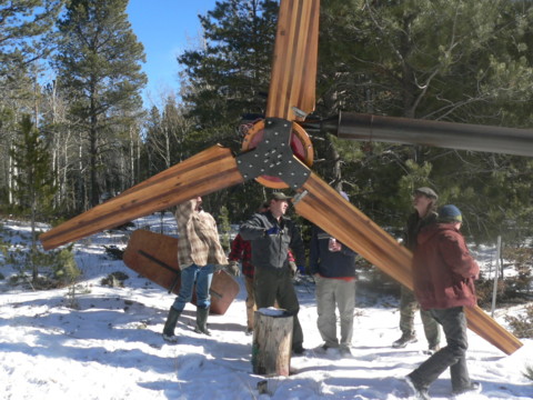

We had an interesting failure on my 20' machine this week.  A connection broke at the base of the tower.  The machine ran single phase for a while before I noticed it overspeeding and making quite a lot of noise/vibration.  We shut it down - but realized that there was also a bad connection at the top!  (wire broke bottom and top)  It was fairly scary because I did this in high winds.  We lowered the tower and noticed that all the nuts that hold the stator had come loose!  Also - one of the wires that goes down the tower rubbed enough on a wire that comes out of the stator to destroy the insulation and a wire from the stator was 'burned off' right down to the resin.  So we had to chisel into the stator and find wires to connect back to.  I expect that all of these problems happened very quickly in the few hours that the machine was running single phase and vibrating intensely.  At any rate - it's all fixed now and no real harm done.
