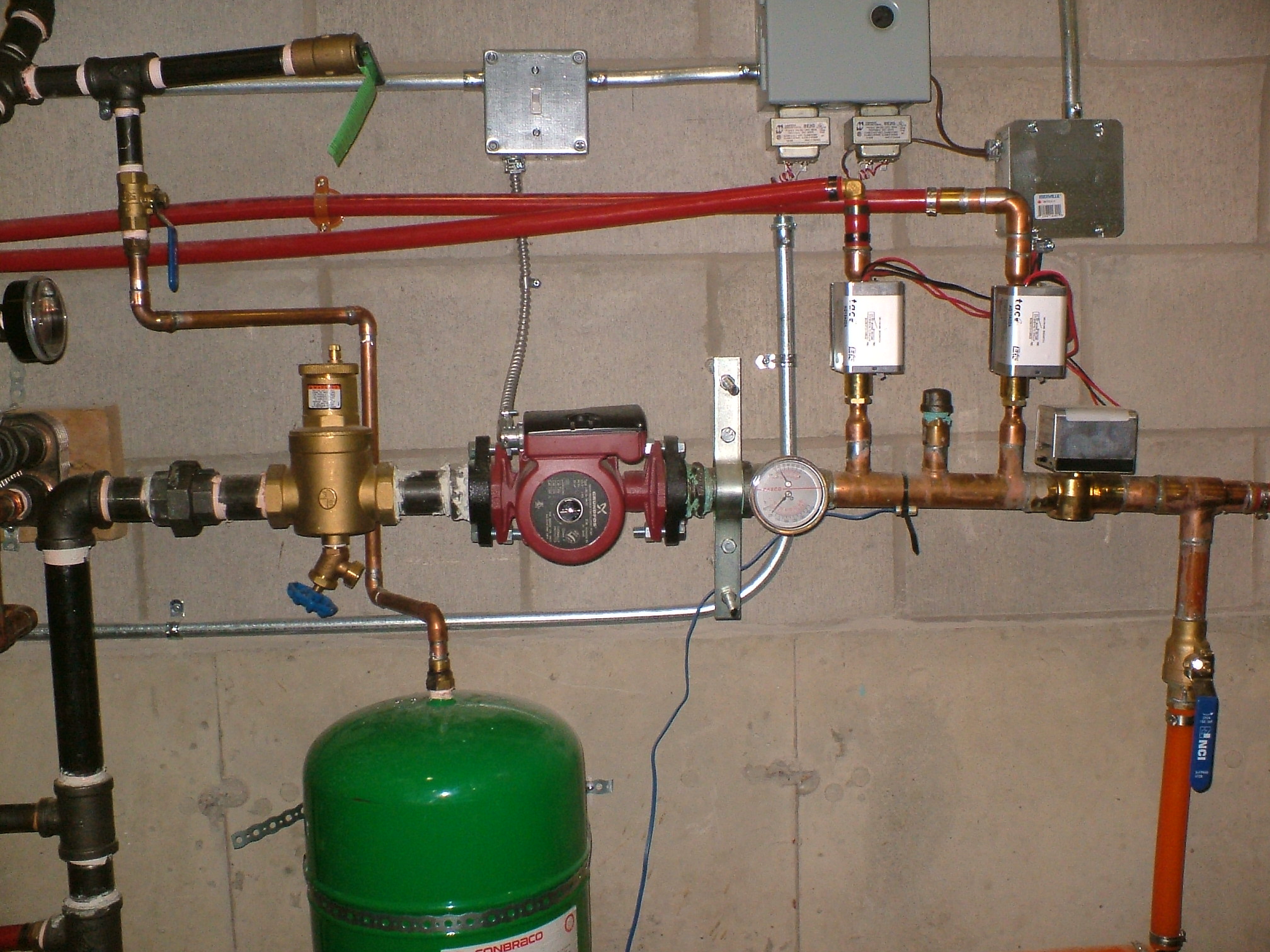

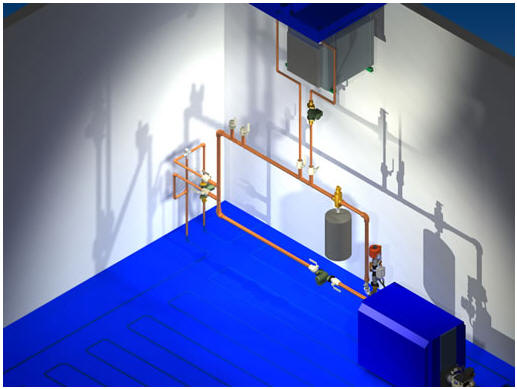

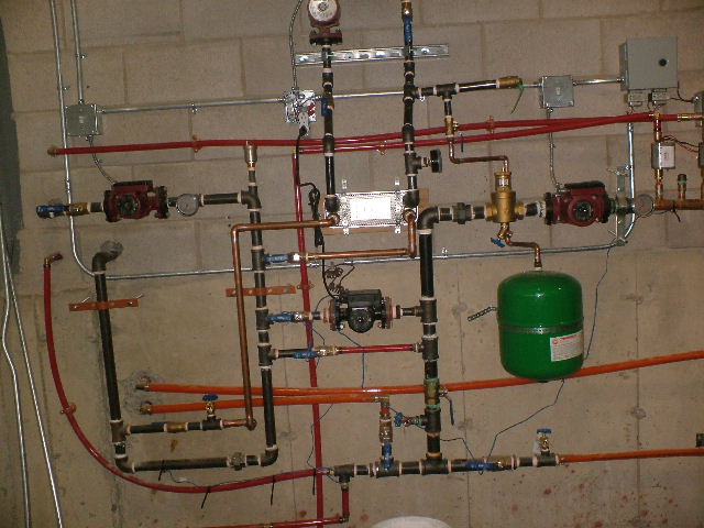

I just finished installing a wood doctor boiler to heat a 10,000 sq. foot garage which we installed infloor heating.
 it has a primary loop with injection system for the infloor,also heated walkway using plate heater so we only had to fill that zone with glycol to prevent frozen pipes.

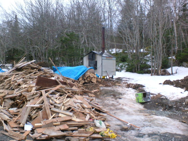

I own a 12 year old Woodmaster 434 modified to run on a newer 4400 control system.  I used to work at Woodmaster building them and got this one second hand and rebuilt it.  http://www.boomspeed.com/bofh1968/stove/index.html
It's odd that you say the outdoor stoves burned a house down as quite the opposite was one of the points that I liked about them.  All high heat producing items are kept well away from the house.  Also all the home owner's insurance companies around here give a DISCOUNT if you use them due to the safety factors.  :confused:
All the fuel, the flames, everything that can get hot enough to ignite a house is kept out and away.  If a Woodmaster caused a house fire, it's because it was installed wrong and put too close to the house, that's the only way it could happen.
If a Woodmaster has a runaway fire, the water will flash to steam at 212 degrees F.  The water pump will not pump steam, so the hottest anything from the stove going to the house will get is 210 degrees (and that's with VERY good insulation on the piping), which is FAR below the 451 degrees F required to ignite wood or paper.  I don't think even gasoline or alcohol will spontaneously combust at 210.
So being an open system (the fill pipe is right behind the chimney at the top of the stove), the steam will just vent to the atmosphere and the stove itself will go into meltdown, but the required distance from the house takes this into effect.  So again, the only way one could have burned a house down is due to improper (and illegal) installation.  Mine is improperly installed (by me) only because it's too close to my wood shed.  But since the shed's not insured and is only used to house my firewood, it's no big deal.
I am with Old F.  I have a poorly insulated 520 square foot modified A frame house and I go through a LOT of wood with this thing.  In the neighborhood of a full pickup truck load of split oak a week at times.  But the piece of mind knowing that my autistic son or any of my cats can't burn the house down by knocking something flammable (curtain, homework, etc) items onto an indoor wood fire heating system is beyond measure.  Also knowing that any and all critters living in the wood pile are not getting inside my house is a little reassuring as well.  Plus there's no chance of smoke, soot, carbon monoxide.  Also a chimney fire is irrelevant as it's only 3 feet long and is out on the boiler.
So yes, they go through one hell of a lot of wood.  They are TERRIBLY inefficient.  But the safety factors and the reliability far outweigh the troubles of acquiring the wood and loading it twice a day.

by nanotech (darrin(dot)moore(at)gmail(dot)com) on Mon Jan 21st, 2008 at 11:21:37 AM MST
You can see in this picture what I mean.
That little shed next to the boiler is the wood shed.  The roof is tin, so even if a spark or ember landed on it, it's going to have to be a hefty lump to start the wood underneath on fire.  And since the shed's only a 10X10, there's not a whole lot of thermal mass there to burn for long.
After this spring though, I might be moving it.  I'm gong to expand the shed to hold the entire winter's wood instead of less than a week's worth.

Re: A question for Out door wood stove users (3.00 / 0) (#32)
by williamG on Sat Mar 1st, 2008 at 10:26:03 PM MST
my set up...home made  stove  250 feet  from house...circulating pump in the basement.. 3 outlet  manifold..1st goes  to  heat  plenum in furnace (plenum full of  rads) original furnace  has  a  24/7 blower in low  speed..thermostat and zone valve control water flow to rads (1st off manifold) ..next is heat  exchanger for  domestic hot  water (home  made) runs  24/7 to this (2 foot long  by 12 inch pipe for  furnace water..and  a  50 foot  1/2 coil inside for  domestic water)..
and  finally  another  zone  valve and thermostat and mixing  valve  to control and maintain  floor heat in  basement...1- 1/2  story  century old  farm house...quite a bit of  insulation  added over the  years and then  i aslo heat  (mildly) a  30 by  40 shed to around  40 or 45 all winter long  for  my  dogs  to sleep in..all this on about 25  face  cords (8 or  9  real cords)
these  stoves  are  not  the most  efficient but  you trade that  off for  some other  things....no  fire in the house...no  bugs in the house..no flying  ashes  when you clean the  stove in the  house....no  sweeping  an mopping  when you have to  pile  wood in the  basement every  month....i built  my  own  stove and  i think i can build  a  more  efficient model and  will begin maybe this fall
