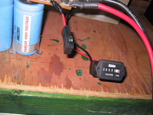

I found this laying around the shop while I was attempting to clean up the other day (its rare that I clean up). It runs on 10-80vdc and since the output prior to the MX is around 72vdc, it seems to work quite well. Overall, I dont think I have even 6 hours runtime on this engine.

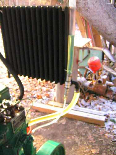

Blurry picture, I know. This is a fuel measurement tube I made up. Its 1.25 inch clear tubing. There are some reducers on the bottom to feed the 1/4" tube that in turn feeds the fuel filter. Its cut to length to accomodate 500mL of fuel. I hung it up with some zip ties to the chain that holds up my radiator.
I ran the engine (under load) to get it nice and warm, probably about an hour. The temp outside was aprox 38 degrees F. I kept pouring in fuel to do this. Once it was warm, I waited till the fuel got to the very bottom of the tube. I then reset the KWH/AH meters and poured in another 500mL. I then kept the alternator under load for as long as it took to let the fuel drop down to the very bottom again. I averaged a 1900 watt load and I got 1.3 KWH for this amount of fuel. This was with the engine set at 650rpm under load.
I then multiplied it out since there are 3785.6 mL in 1 Gallon.
3785.6 mL / 500 mL = 7.5712
1.3KWH * 7.5712 = 9.84256KWH's
9.84KWH per gallon of diesel.
Overall this is pretty good and efficient. Im curious what it will do on WVO. Almost have the conversion done :-)
