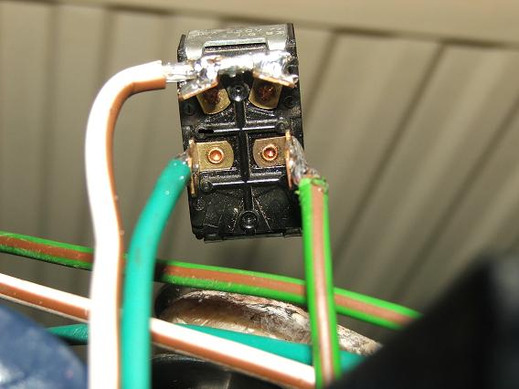

 ive just been playing on the bench and doing sum fun testing.
 i have menny switches . but the one ive fitted looks the best.
 as its a single throw.  i have better but there  double throw.
  it has four terminals on the back.
  i have soldered the three wires .or the three phase . one to each terminal.
  the spare terminal i have put a bridge across.
  using the same wire.
  i thought the switches were meant for dc but on reading what it said on switch .
 it said 15 amp -250 v then ac.
  but that confused me as i thought it was a 12 volt type switch. dc.
  but on thinking . i am connecting it to ac any way. so that might be ok.
  spinning like mad i flick the switch and it works great.
   very impressed.  but i can still turn rotor very slowly.
  just a gentle turn and it still moves round but not fast.
   ive been reading that it should brake and stay stopped .?
   but how can it stay stopped . only a friction brake can do that surly.
  so far im very happy with the what ive done.
  but as the brake switch is very important i will ask for the OK.
  so dos it look right.   and what i done to wire the switch up is it right.
  its better to look at pic.  so put one on here.
  if it is right . then i will be happy and can move ahead a bit more .
  if in dought  ask . i have been told from when i was a kid  .
  switch needs to brake a six coil -8 mag with six foot prop.

It'll always turn slowly as when it is stopped there is no force acting on it to brake it, it'll get up to a slow speed where the power it's putting out at that speed is the same as is being absorbed.

The switch is wired up correctly and should work pretty nicely.
Others have attempted or thought of a resin-less stator and it can work pretty nice too, others would have more information on that.
