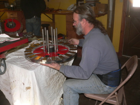

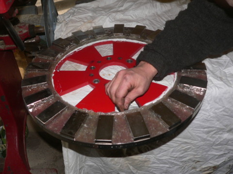

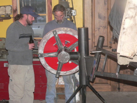

Tom White is building a 20' turbine just like mine.  Pictured above is one of his magnet rotors.

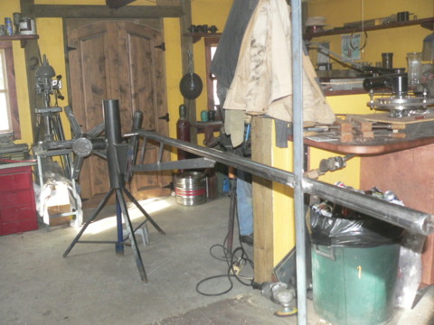

Finished metal work for a new 20' wind turbine.

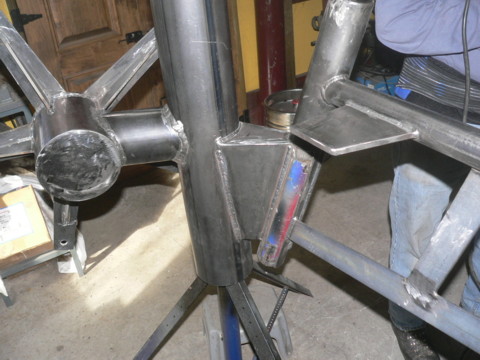

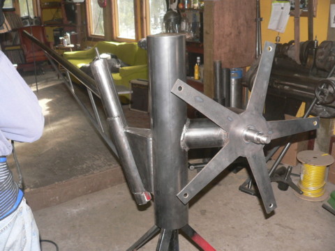

Detail from the back side.  On mine we made the stator bracket from 3/8" steel and I never put gussets on the 'arms'.  This one is quarter inch steel and we put gussets on them.  In the end its probably lighter weight and stronger.  Also notice the 'box' we built to hold the tail pivot on - it's about the same as mine...
Same thing from the front.

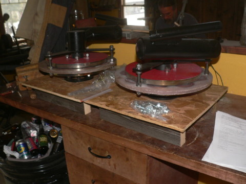

Two little 10' turbines on cute little pallets ready to ship to Tenn.

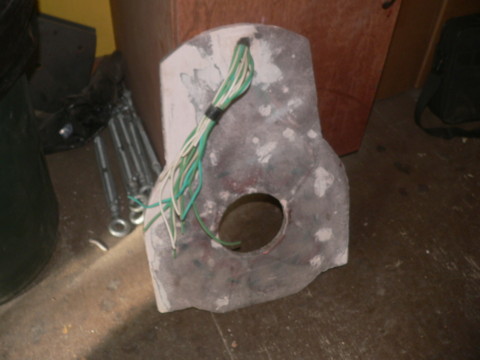

This is a new stator for Scotties diesel 'mini petter'.  The old one still works but were hoping for a bit more power/efficiency.  This has 8 coils (basically an 8 phase alternator) - each coil will have its own rectifier.  Im hoping for close to 100 amps @ 12 V (1200 rpm) from this one.

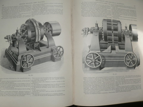

There's a picture from an old book I have... for those of you who thought axial flux alternators with adjustable airgaps were a 'new' idea!  (this is from the 1890's)

"Two little 10' turbines "
Little and 10'?
(little. small in size; not big; not large; tiny:)
Seems a bit off.  Maybe thats just me...
Re: Jan 5 2008 (3.00 / 0) (#4)
by Volvo farmer on Sat Jan 5th, 2008 at 08:09:23 PM MST
Dan's turbine is 20'
Seems only twice as big until you figger out the pi R squared for the swept area.
Yeah, 10' is a small turbine when you look at it that way.

Nice.  The quality of workmanship is continually, visibly improving on your projects.  Thanks for sharing and for the inspiration.  -kitestrings
