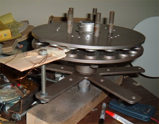

Re: Little help wanted (3.00 / 0) (#15)
by wooferhound on Sun Jan 06, 2008 at 10:10:46 AM MST
Here is a picture of a electric coil winder that I made.
under the coil winder is a piece of wood with an openended round hole in it.
This is the jig that I used to hold the test coil in the magnet rotors.
Just tape a coil in there and go . . .
W o o f -={(
Re: Little help wanted (3.00 / 0) (#16)
by CmeBREW on Sun Jan 06, 2008 at 10:14:54 AM MST
I just put a layer of masking tape around the coil and tape it to a small piece of 1/4" plywood attached to one of the stator mounting bolts to do the test coil.
Re: Little help wanted (3.00 / 0) (#17)
by CmeBREW on Sun Jan 06, 2008 at 10:18:17 AM MST
Sorry,,,forgot the picture
I love tape---where would we be without it.
