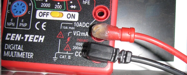

uh , no I wouldn't try powering those from the device(;-))
There's a 9V'er in there. cheapo but it'll last about a week of steady use.
The directions that come with it, say to use of equal or better battery.
They are Nice though.
The cables, if you twist them, too many time will come off at the instlated end, cheapo alligator clips from same store will work to repair :-)

I agree about the cheapness of the probe leads.  That is one of the "flaws" that I sometimes find in initial checkout.  The lead will become open-circuited or intermittent at one end or the other after a little bit of rough use.  Luckily, the connectors on the meter accept standard banana plugs, so you can hook up with jsut about anything.  The other flaw I sometimes see is dark patches on the LCD display.  Doesn't affect the measurement, but it's a cosmetic defect.  You have 30 days to exchange any defectives, that's why I recommend checking them all as soon as you get them home.

The only common problems I have had is low factory batteries, and issues with the leads melting somewhere between 25 and 150A when testing battery voltage while the meter is set to 10A.  And that is why I use them (only $3 per major operator malfunction).

I've done that one too.  I bought a batch of them at $1.99 at Harbor Freight a few years ago, between giving a few away, losing a few, and cooking a few - usually by leaving the lead in the 10A slot, now I only have one of those left.  Rich

I've used Auto Goop gel to patch the leads after they fail. The wire lead is spot welded to the banana pin and then the thing is dipped in vinyl (red or black) at the factory.
If a lead fails, cut open the meter end, strip, wrap and solder the lead and then add Goop.
The new right angle connector is the old plug (hole keeper).

Great idea - I hadn't investigated to see which end had failed, I've just been replacing the leads with another banana lead because I have a "bunch" laying around.

The first thing I did with my 1986 Tandy DVM was clip the plugs and solder directly to the meter main board. Twenty-two years and never lost-damaged-pulled out yet; if there are multiple sockets choose wisely or add multiple leads....

As far as "cooking them", getting your your 10A and 1A settings backwards....  check the fuse in the meters.  You may be able to resurrect the meters by replacing the fuse.
However, some of mine have been a bit erratic on the 20V setting (which is where it stays most of the time, and unfortunately is exact opposite to the 10A setting).  Usually it will settle down, but I'm about ready to track down a more professional unit.
They could also use a little more wire in the leads.  The probes have fallen off of most of mine now.
