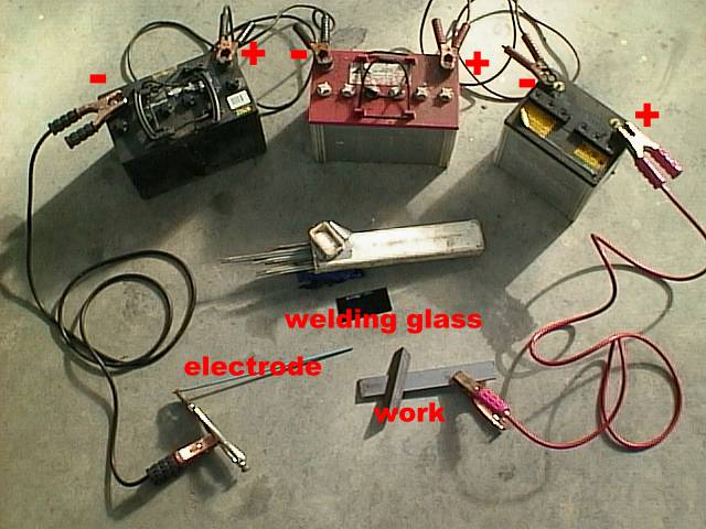

batt .welder (3.00 / 0) (#15)
by hiker on Mon Nov 03, 2008 at 11:48:47 AM MST
might try this out for practise.....
WILD IN ALASKA
Re: batt .welder (3.00 / 0) (#16)
by JW on Mon Nov 03, 2008 at 01:26:59 PM MST
What Hiker is illustrating does infact work. Weve seen several members use this technique.
 It does use ark or stick welding rod(this has flux on the outside of the weling rod/stick). Which would classifiy it as a type of ark welding.
 Although I learned to weld with an ark welder for steel. I preffer MIG.
 'When your ark welding, it definitly takes much more skill'.
 Such as striking an ark, and breaking a fused rod(to the work peice) as fast as possible.
If you just use a filter glass[welding glass] alone to protect your eyesight, you should be at an advanced level of experience.
