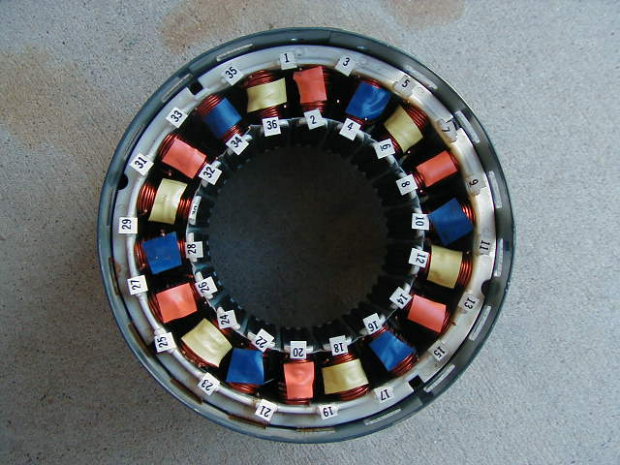

Hello all, first post to this board after I stumbled upon it. I've been reading up on making a wind generator out of the GE variable speed ECM motors 1/2- 1 HP on various boards and finally got some time to start on one. I do HVAC work, so getting my hands on used but good ones is no problem. I plucked 3 out of the scrap pile at work last week and began to play around with them. The one in the pic with all of the number/color coded stickers on the windings I actually broke one of the start wires off one of the coils, so it's junk. Figured I'd use it for illustration and if a stator, bearings, or end cap ever go bad I've got spare parts.
 I have one wired up like "Jerry" from this board did in some of his older posts, but there's a lack of new information and some of the posts/pics didn't show up or weren't real clear to me, so I figure I'd document my build as I went. I'm at the point now where I'm trying to figure out how to wire the 36 wires coming from the end bell of the motor into three phase so I can rectify it to 12vdc. I've read and am still trying to comprehend star and delta configurations and what works best, but I figured a picture is worth a thousand words for people to explain what works best to wire these things. So my main question is what wires below should be wired together, series/parallel? The start of each of the 18 coils in the pic is an odd number, the end is even. For example phase 1 start is 1, end is 2. Phase 2 start is 3, end is four, phase 3 is 5 start and end 6. Around it goes until you end up back at the start.
 I've read two tales of how to wire it up. From my understanding, correct me if I'm wrong, to wire it star, I would wire nut 2,4, and 6 together. For phase 1 (orange) Then I would connect 1 to 7, 8 to 13, 14 to 19,20 to 25, 26 to 31, 32 to 1, and then attach a lead to go the rectifier diode. Phase 2 (blue) would be 3 to 9, 10 to 15, 16 to 21, 22 to 27, 28 to 33, 34 to 3, and to a lead to the next rectifier diode. Phase 3 yellow would be 5 to 11, 12 to 17, 18 to 23, 24 to 29, 30 to 35, 36 to 5, to a lead to the last recifier diode?
I've also read to just wire all the starts and ends of each phase together parallel, 6 in a group. In other words phase 1 orange starts would be 1,7,13,19,25,31. Phase 1 ends would be 2,8,14,20,26,32. Phase 2 blue starts would be 3,9,15,21,27,33. Phase 2 blue ends would be 4,10,16,22,28,34. Phase 3 yellow starts would be 5,11,17,23,29, 35. Phase 3 yellow ends would be 6,12,18,24,30,36.
After these are all tied together six in a bunch, you would tie the ends of all phases together, eighteen in a bunch, and the other 3 groups of six start wires for each phase would go to each of the 3 rectifier diodes?
Any help on the best way to wire it for the most power would be appreciated. I'm at the point right now where I'm ready to build my rectifier and need to get this wired. Welding up a stand, tower, etc.. is the easy part for me, I'm just a visual person and the only way I could think of getting my answer was to post a pic for all to see.
Thanks,
Pat

Here's a broken down pic of the internals of one marked out by phase - orange phase 1, blue phase 2, yellow phase 3. Starts of each coil phase are odd numbered, ends are even.

by ghurd on Sun Oct 5th, 2008 at 06:38:13 PM MST
What voltage?
What HP motor?
Do you want 'some' power in low wind, or lots of power in high wind?
Not that I can be much help, but thats what "we" need to know.
It wasn't really necessary to completely separate it down to individual coils!
You know used working (with good brains) 1/2~1HP ECMs are fetching big bucks on ebay?  It would be a shame to send them to the landfill.

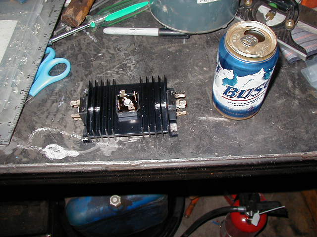

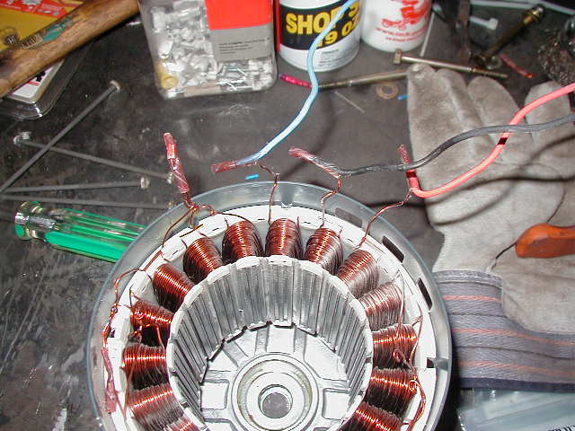

Can't see your pictures? I've found for 24 volt use, just leave the ECM wired stock. Don't even open the motor can.
Then wire the unit 3 phase star. For 12 volt use, open the can, find the star point conection. Next, seperate the 3 leads at the star point.
Identify each of the seperated wires with its corisponding original power conection wires (continuity tester).
Now you have the 3 phases identified, solder an added lead to each of the seperated wires. Bring them out of the motor can, paired with there phase partner.
I like to twist each pair per each phase together. Now use 3 seperate fullwave bridge rectifiers. Wired "Jerry Rigged".
Its now ready to fly 12 volt.

 After taking apart a stock 1Hp ECM tonight to see what Jerry was talking about in his response, this is what one looks like when you first crack the case.
 The star point connection is where the three coil wires tie together. I think I made a lot of work for myself seperating each coil because to me it looks to me like they are wired 3 phase star right out of the box. In other words the end of each phase coil gets wired in series to the start of the next. It seems to me GE has packaged it for you already without having to run the cluster of wires out of the end like I did or Jerry did in some of his old posts.
 According to Jerry's post, I just need to cut the star connection 3 wires apart and find out which one is continous with the red, black, and blue wires that originally had the quick connect plug on them from the factory. The run the total of 6 wires out of the end cap to the 3 rectifiers. If it's that simple, I wasted a couple hours of time seperating coils.
 Am I on the right track here? Hopefully I can pick up my heatsink and diodes tomorrow.

Add 3 wires.
Yes, it is that simple.

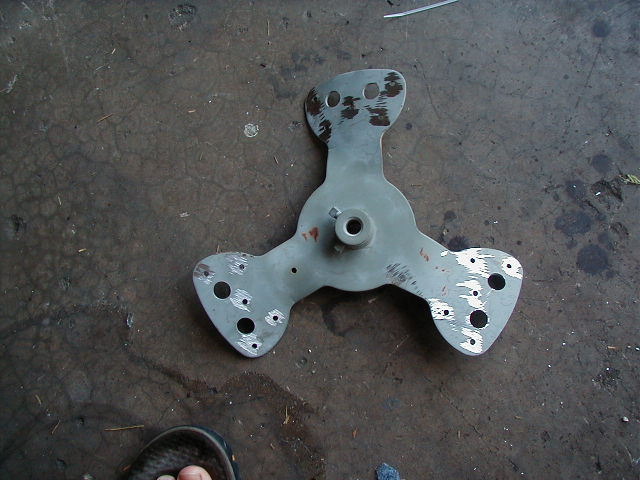

The pic of the three on my workbench shows one with a condensor fan blade from a Trane heat pump on it. We had a probably 5-10 mph wind yesterday, just a nice breeze, and I stood up on my roof with that set up and it spun pretty good. I didn't hook my tachometer up to it since my girlfriend didn't want to climb up there and measure it while I held it, but it spun pretty decent IMO. Thinking of using this gutted hub with some pvc blades unless someone tells me I'm stupid for doing so?

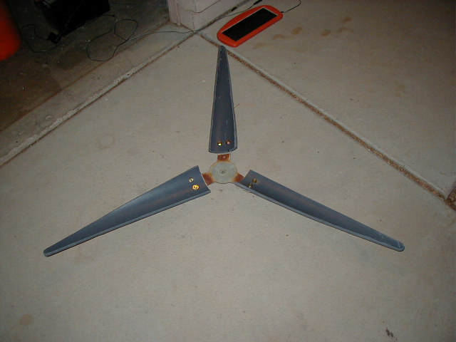

The condensor fan blade was barely turning.  They don't work very well.
"Real Blades" turn so fast it will scare the tar out of you.  Not something most people hold in hand more than once in good wind.
Like Norm said, need to make sure the fan blade hub doesn't come loose and fall off.
I use a few of the HF drill stops (50 cent coupon sometimes).  May be enough room on the factory shaft? LOL.

 Got a couple free hours tonight to work on it. We had some 6" schedule 80 PVC scrap at the shop, so I snagged it for the blades. Cut it in quarters with a circ saw and made the hub end 5.25" approx, the tip end 1.25" approx. Gave it a round sanding, still need to final sand it with a DA and paint it. I will probably add a third bolt to each, I ran out of 3/8" grade 8's, only had six with nylocks at the house. Tip to tip it's right at 48".

Stopped by a local electronics supplier today and picked up 3 full wave rectifiers and a heat sink. They're rated 40amp, surge is a little higher 50 amp maybe? Pretty small, maybe an inch square. Look easy to hook up, ac in on two lines from each phase and 12vdc + and - out. I'll probably mount it in a scrap gutted 60 amp a/c disconnect box I have sitting in my scrap pile at the base of the tower. I can open the weatherproof door easily and leave it open for heat dissipation if needed. It doesn't rain that much in Phoenix to worry about moisture. You know if it's going to rain usually.

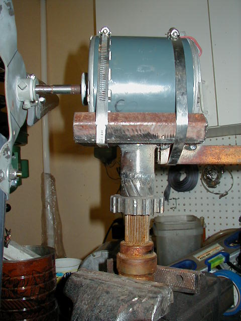

Made up a quick motor mount tonight. Used some 1/8" plate and 1x1" square stock with large hose clamps. The pivot point is the mating input shaft of a Jeep transmission to a transfer case that I had from previous projects. It has nice roller bearings internally, and was made to handle a lot more load than this thing will throw at it. The vise end will slip inside my tower pole and get welded.
 I also hooked up the rectifiers and tried it on a old trailer light. I was trying to watch a multimeter, hold a digital tachometer to see cut in, and modulate an 18v cordless drill. It proved a couple tasks too many, and I took the smoke out of the light. From what I could tell, cut in was around 370's. I'll need a dump load and charge controller I'm sure.
