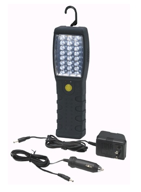

by dnix71 (yahoo.com 'dnix71') on Tue Oct 7th, 2008 at 06:38:35 PM MST
Nice work on the mill.
This type of light from HarborFreight might be handy. It has an internal rechargeable battery that can be recharged from one of the car batteries you are using or run from the battery or run from an inverter.
http://www.harborfreight.com/cpi/ctaf/displayitem.taf?Itemnumber=95181
Re: She Flew!! (3.00 / 0) (#6)
by mixerman on Tue Oct 7th, 2008 at 06:56:24 PM MST
I just got HF ad today , ther 20 bucks until OCT 27!
