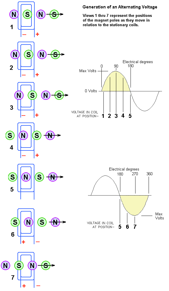

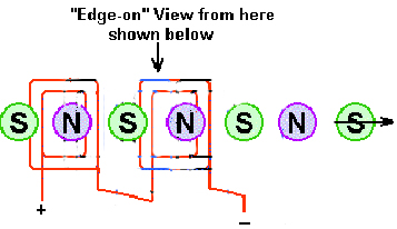

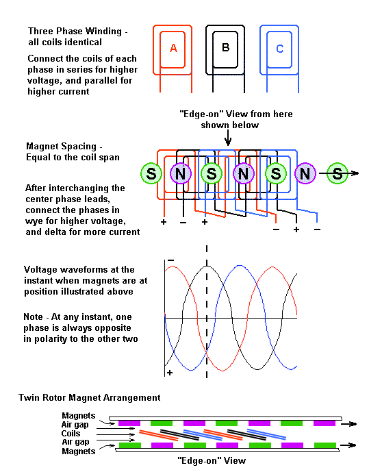

These pics show the coil / magnet relationship you want to try for:
"ElectricEd" posted these long ago and I archived them so not my graphics.
Hope it helps.
Also note that this was back when folks overlapped coils to pack in lots of copper. The basics are the same tho.
Re: Poles v Coils (3.00 / 0) (#4)
by TomW on Tue Oct 7th, 2008 at 07:45:59 AM MST
You might be better off ignoring the first graphic and concentrating on the second as it is more basic and less confusing than the lapped coils in #1. Pay particular attention to that N over one leg while S is over the other on each coil bit.

Thanks very much .... This is the answer I was after .. where each coil must see the same pole. Please add my rubbed out version of your image to your archive. It was really clear to see after black and blue phases were removed.
