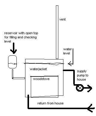

by LanceA0 on Sat Nov 08, 2008 at 03:13:55 PM MST
this is what im thinking as far as a design. the measurments are rough, seeing as im not sure how many gallons of water i need to heat.  tell me what you think.
http://s2.photobucket.com/albums/y39/LanceA0/house/?action=view&current=woodburner-1.jpg
http://s2.photobucket.com/albums/y39/LanceA0/house/?action=view&current=woodburner1.jpg
Re: Outdoor wood burner idea for my house..help me (3.00 / 0) (#10)
by zeusmorg on Sat Nov 08, 2008 at 05:07:57 PM MST
 I would put cold water intakes on both sides, and a hot water output at the top...otherwise you'll run into flow problems.
Re: Outdoor wood burner idea for my house..help me (3.00 / 0) (#11)
by LanceA0 on Sat Nov 08, 2008 at 05:45:23 PM MST
in the side picture you will see dotted lines those are plates  welded on inside of the tank used to direct the water from one side to the other. however your idea would be cheaper and easier do you think it would be efficent?
how does the design look? you think this will work effiecently?
i also figure i will put the pump on the pipe heading back to the wood burner. that way the water temp should be cooler and posibly prolonging the pump a little bit longer.

 Even with the baffles(which i did notice) you want your hot water to exit from the highest point of the tank..
 If you do it as you drew, you'll have some water trying to rise from the hot water outlet side to the highest point of the tank. (heat naturally rises)
 If you put the cold water into the lowest points, and remove it from the highest, you will get the hottest water out.
 Yes it is fine using the pump on the cold water side.
 I would also install a sight glass on your expansion tank. that way you know when the water level drops. It may even be worthwhile to install a float valve for automatic water replenishment.

my drawing showes a vented overflow tank. the vent is to eliminate any pressure build up. will that be enough or should i install a pressure releif valve too? the over flow tank will probably be a gallon tank. i will keep some water(1/2 gal) in there that way if the tank gets low gravity will fill it back up. then if the water expands it will expand back into the over flow tank. similar to a car radiator system.
do you think my idea of the coiled heat exchanger in the 15 gallon hot water tank will work?  how many ft of coils would i need?

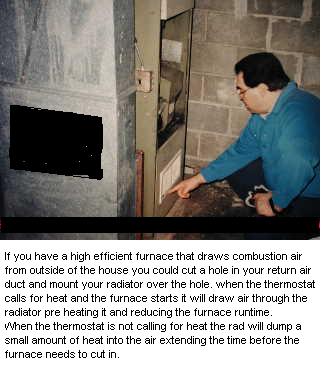

Check this picture for my idea on your radiator placement, over the black hole in
the return air shoe, not the grill he is pointing at.
src="http://www.otherpower.com/images/scimages/7822/DuctAtFurnace040DFss.JPG" width=80%>
I think your tank on your wood stove would work if you could keep it in close contact to the stove shell for maximum heat transfer.
You would probably be better off with a larger tank, in order to have a cushion, if
you are not drawing heat from your radiator or heat exchanger, the 7 cubic feet of
 water in your tank  (437 lbs.) will heat from 112 degrees to 212 degrees (boiling)
(437X100=43,700 btu) in 1 hour if you had a 87,400 btu fire and a 50% heat transfer
from your fire box to tank.
The reservoir should be at the same level as your tank with a loose cover to prevent
excessive humidity into the shop and allow easy access to check level and fill.
With the reservoir in this position and a large open vent if the water does boil it
won't be blowing a gallon of scalding water out at roof level (think hot shower)
The circulating pump is designed to handle hot water and should be below the tank level to eliminate air locks. If you put it in the return line and any leak develop
it will suck in air and airlock, with it in the supply line any leak will show
immediately and can be dealt with. You may want to insulate the outside of the water
 jacket to prevent overheating the shop.
here's a crude drawing of my idea.
Some ideas and suggestions, feel free to poke holes in them.
Best of luck
Kurt
