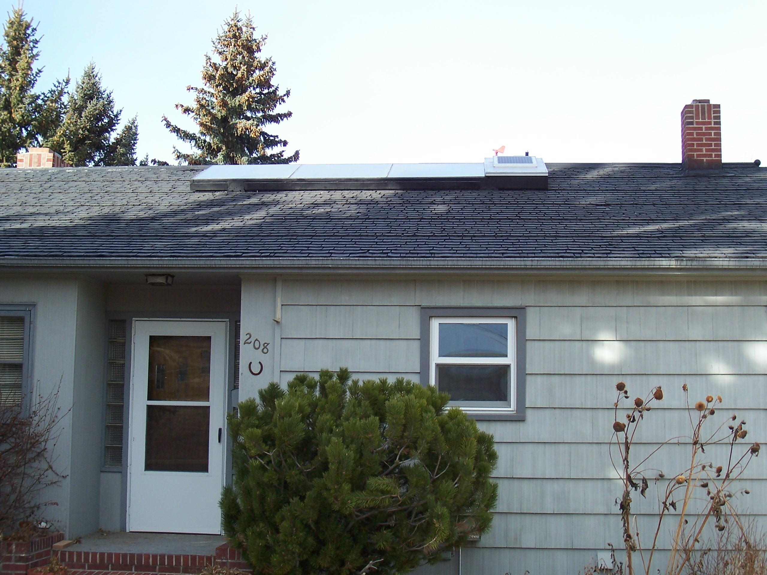

I built and installed a Preheat tank system.
last fall, mid of August,On roof.
I have kept a diary through the winter as we Live in Montana. My
preheat tank is Electric 50 gal.(our main Indirect 40 gal tank is heated from a hot water boiler for home)  weather outside was -20 degrees below F
we had A lot of reflection from snow but,with clear sky's. the system raised the 50 gal.temp in tank 9 degrees.
I spent around $1400.00 on my system that includes 12 v pump and PV panel cost 2 flat plate heat exchangers also. Copper prices were high when I built it. my glass was free.I couldn't justify twin Poly as I considered it,till I saw the price.

by fcfcfc on Sun Feb 01, 2009 at 02:14:24 PM MST
Hi:
9 DegF after a full sunny day????
How many square feet of panel???
How much hot water was used over that sunny day???
What was the starting and ending temp???
How are your panels constructed???
What kind of heat exchangers???
