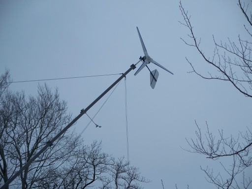

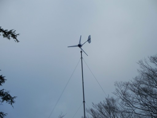

Hi everyone,

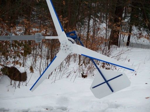

Well, finally after three years of reading and experimenting I was able to raise it up. And no better day than christmas day.  When my daughter asked how it got there, I told her old santa stopped by and dropped it off for me.  All day it was like being a kid all over again.  Anyhow, we have had some great winds around here and was able to see it put out over 30 amps into my resistor bank the other evening.  For those of you that don't know I have a 24 volt setup and my genny is aloft about 84 feet.  It was furling like it is supposed to.  I am going to try and upload some pictures of how the day went.  Thanks again for all your help.  Chad

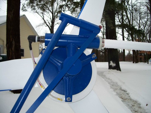

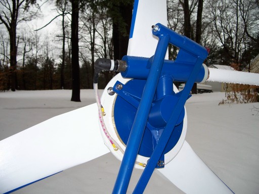

I agree with Tom, thank you for posting what you have done and not what you think other's should do. Great looking project and I wondered if your slip ring arrangement is one of those mercury types ? (Mercotac) The only thing that stopped me from using one is that there would be no way to run my brake cable directly up through the middle so I go with the manual un-wind and range plug system. Works fine as mine is 85' up also so it takes a lot of turns to have to be concerned but I would much rather have the slip ring arrangement and brake some how. I look forward to your updates on performance. Again, great looking project.  Dave B.

That in fact is a Mercotac rotary union.  Don't know how it will hold up but it should last for some time.  The only draw back that I see with them is that the terminal lugs are very tight (close together).  I was in the car driving tonight and got to thinking about your setup and was woundering if you wanted to use one of these (mercotac unions).  Just might be able to model something over this idea.  What I was thinking was using a simular setup like I've seen on the front headset of those free style pedal bikes.  The one's used for the front brakes.  If you catch my drift.  Just a thought.  P.S. Like your set up and the blades also, are you guys making those by hand or is it automated??  Thanks again Chad

Nice.  84' still sounds like a long ways up.
What is the hardware and rubber where the wires go into the tower?

Thanks again for the wounderfull comments!!  It does seems like it took forever, But for those of you out there don't give up!!  The day will come and the hard work will be worth it and rewarding.  I couldn't of asked for a better day.  The winds died down for christmas day and the sun even came out for a while.  It was cold but I could care less.  I was determined to get this up but that was mostly procrastination on my part.  A little insite into the project. Thanks to the Dan's for the plans.  It's a copy and went together as their plans call for.  I added the locking hardward for the tail so the tail could never come up and make contact with the blades.  An answer to the down tube wiring, I ordered a rotary electrical union (slip ring) so I wouldn't have to worry about the wires ever getting tangled up.  I ran #6 all the way up the tower and also to my rectifier box located in my barn.  I used some short pieces of #10 at the top of the tower to make the necessary connections.  The whole machine sits on a timmkin taper bearing and supportated at the lower end with an uhmw slip bushing I spun up at work.  My tower is 80' tall with a 4' stub.  I used 4" square tubing with an 8" square bolting flange at the top and bottom of 20' sections.  Hope this helps you all out.  Thanks again and Keep Them Flying!!  Chad
