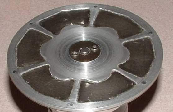

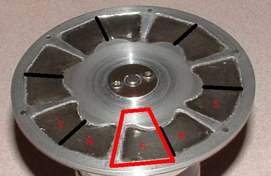

So I have slowed the alternator down. This is what I call the Axial Flatpack. It is made from crashed compact harddrive magnets.
The unit runs at a maximum of 18000 rpm and at that speed it puts out ~ 300 Watts ac. The magnets are set into a 1/8 " aluminum plate. There is a magnetic stainless steal plate bolted on behind the magnets. The disk was then balanced.

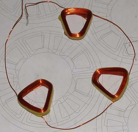

The coils were wound on this plastic jig. This allowed very even spacing of the three coils that have 36 turns of 21 guage wire. Also the coils were connected together to reduce connections.

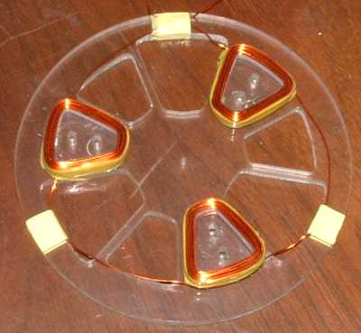

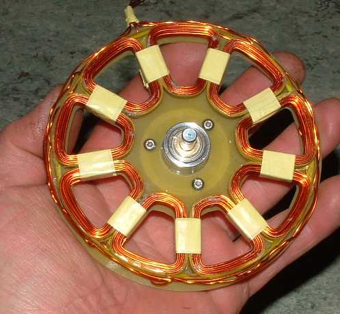

This picture shows how the jig allows the coils to fit together. They are tapped in place on a 1/16" epoxy board cut with the same form.

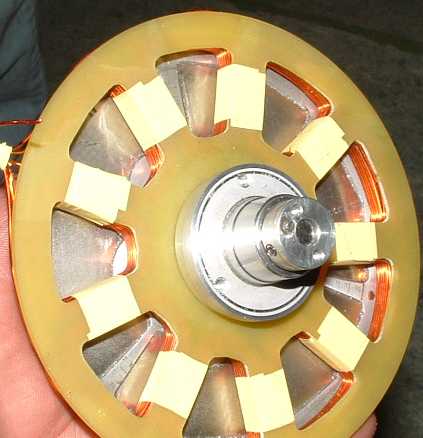

The hub was made from and old VCR head. They are easy to machine and very accurate. Speed over voltage curve testing will be done next week and then I can decide how to couple the turbine to the alternator.

 For the newbies, each magnet has a north and south pole correct? That would make it the same as a 12 pole/ 9 coil arrangement. Please correct me if I'm wrong Joseph.... Beautiful work :-)  Gary D.
Re: Axial Flatpack (3.00 / 0) (#4)
by WXYZCIENCE on Fri Feb 1st, 2008 at 08:36:46 PM MST
Gary, you are correct there are 12 magnets. Here is how they are arranged, and the coils are all wound the same direction. As I mentioned before there is a 1/16" steel plate behind the magnets.
With the old compact harddrives the magnets are held in place by two small drops of epoxy. This makes them easy to remove. Thanks for your input.
