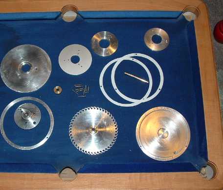

I have had this idea for while. These are all the parts.

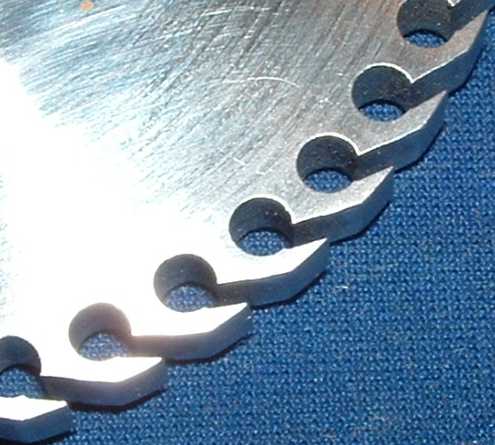

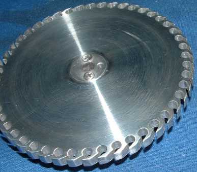

The main part is the 48 tooth blade.
This is a full view of the blade.

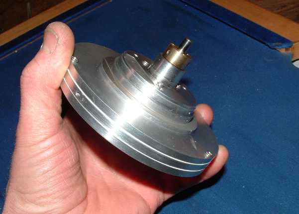

Here is the turbine assembled and sitting on my pool table.
I am holding the turbine here. It has been tested to 10,000 rpm and will be further tested in the future.
I will post results of steam tests and high-speed alternator link.

I am not fully understanding how the steam flow will act on the turbine. where does the steam enter and where does it exit? This is like no other turbine I have seen.
