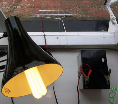

I made one very similar 12 months ago.
5w panel, 7 ah battery and a 12v 11w cfl - still works today.
cost approx 100 u.k pounds ($200).
The only problem is that the anglepoise lamp is sprung for the lighter incandescent bulbs, the heavier cfl's make the lamp head drop down - I'm not sure what will happen when incandescants are phased out - a lot of drooping anglepoise lamps I suppose...
Ben.
http://www.gotwind.org/solar_anglepoise_lamp.htm

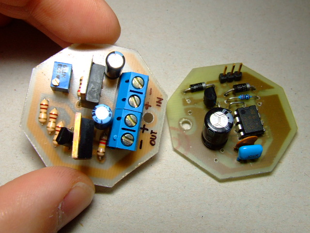

LED bulb - handmade, using my recipe. By using one PWM circuit (I build one using a 555 timer) you could dim the light when you don't need it so bright.
Wires - new. Telephone wires? UTP cable?
LED controller - LM 117 adjustable voltage regulator set to output 9V for strings of three LEDs. This way you will have power even when the battery goes down to 11.8V.

by claude on Fri Feb 8th, 2008 at 06:09:12 AM MST
see this one: http://www.dprg.org/tutorials/2005-11a/
or, http://www.uoguelph.ca/~antoon/circ/pwm555.html
It's simple to make. One thing is that it won't go down to 0% or up to 100%. You could adjust (by using germanium type diodes) the output in between 2% -- 99 %. It's good enough for me.
I made it and used it along with a LM117 voltage regulator and a MOSFET-based current limiter and so I got a regulated voltage&current driver + PWM adjustment. Sweet.
It all looks like this (to the right, the 555-based PWM):

Oh, I forgot, the three pins on the far side are for connecting the 50K Pot.
