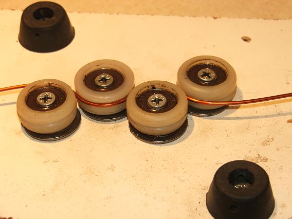

 just like to say a big thank you to OZTULES.
 from him i got the idea to make my own wire straightener.
  i already had the bits i just needed a bit motivation.
  so when i saw the pics oztules posted on recycling copper wire post.
  i got to work. yes it was simple to make .yet works so well.
  i think wooden wheels from a kids toy would also work.
   the bearings i had already had. nylon on them .
  methinks they come from sum type door runner. but cant remember whare i got them.
  only mod i made was a small groove .before i made the groove the wire kept slipping off.
  in the pic its got a 14 gauge wire on it.
   also tried a 20gauge . all came out perfect for winding coils.
  but had i saw a thing like this on ebay i might have paid out a bit of cash for it.
   it was also a great feeling after i saw how good it worked.
   made from junk . for straightening junk.
  i bet my coils will be much neater in future
    so menny helpful folk on here who pass on there good ideas.
    might also be useful to redo any coils or windings that went wrong.

Hi: Pretty good....
Re: straightening copper wire (3.00 / 0) (#2)
by Ungrounded Lightning Rod on Fri Feb 29th, 2008 at 07:26:30 PM MST
Nice.  Simple, cheap, and effective.
I've straightened wire before by chucking one end in a vise, the other in a power drill, leaning back, and spinning away.  But that stress-hardens it a bit and can change its gauge.  This looks like it will leave the wire in much better condition.
But I'll still make twisted pair with the drill and vise.  B-)

Very NICE work-
 From the picture, on the right side it looks
 like the varnish is cracking and falling off?
 I've used clear fingernail polish and
 spray can clear to re-coat this on my recycling
 of wire. What are you doing???

i doubt the enamel is cracking off unless it has got very hot. its tough stuff. unless it is very old  lacquer covered wire. if you go into a motor rewind shop and see what they do to wire you will know what i mean. if it is  wire from an old transformer or something the varnish  it was dipped in, to hold the windings together to prevent noise, might come off,but not the enamel. good idea by the way.

I have noticed when taking apart one particular motor that pulling wires loose from eachother (they were varnished to eachother) took the insulation of the wires and left one of the wires with bare copper.
Apparently, the baked/dipped varnish adhered better to the wire lacquer than the lacquer adhered to the copper itself...
This was another confirmation of my plan to never ever bother with re-used copper wire. Others seem to get good results though. But apart from living on a (nearly-) deserted island (Hi Oz ;) ) I think it'd be much wiser to spend a few $$ and buy new wire.
At least, it's what I do.
Would be a shame after having spent dozens of hours building a generator having to arrive at the conclusion that it doesn't work because the wire insulation failed.
Also notice that the back-and-forth bending of the copper wire stress hardens it. It becomes harder and more brittle and may break when bent a few more times again. And become more susceptible for fatigue.
Anyone who knows me know I'm a scrounger, but sometimes one needs to use the best quality materials available. In the case of generators, that would be copper wire, magnets and epoxy. One could compromise a bit on the other parts, I suppose.

well sum good comments.   at first i was afraid i might strip or tear the enamel off the wire.
  but after a while i started to just try and get the enamel off.
  so i would understand how much it took to remove.
 so bob your right its very tough stuff that enamel.
  so considering the wire hasent been overheated in the past . and looks good
  then i dont see a problem.
  but after i wind a coil i test it every way i can.
 it was great when i made the rotor as i could test with rotor in lath and watch the ac out.
 but now rotor is fitted to the gen i can only test with a meter .

  in the pic i can see the lighter colour bit it dos look like a bit missing.
 but that was a bit test wire i was using when playing with and setting the rollers.
  as yet i havent tried to repair enamel damage.
  there was a coil i wound that had a wee bit missing.
  but as the wires it was laid up to were good i done nuthing.
  once the coils are potted only bad over heating will make the coils lose there insulation .
  as this is all a learning curve for me. its good i dont need worry about what i do with expensive new wire.
  and peter yes i found a motor that was the same as you talk about.
 it was a pain to try unwind. it to was pulling off the enamel.
  but as it was a fast spinning type thing. then that's why it had varnish on it i suppose .
 looks like transformers are better.  or the field coils on the stator .
  but the fact i found one thing pulling off the enamel. dident stop me in my tracks .
