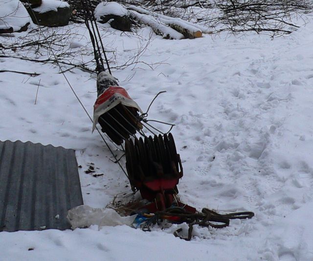

by Janne on Wed Mar 19, 2008 at 12:06:57 PM MST
Something like this would be the ticked.
