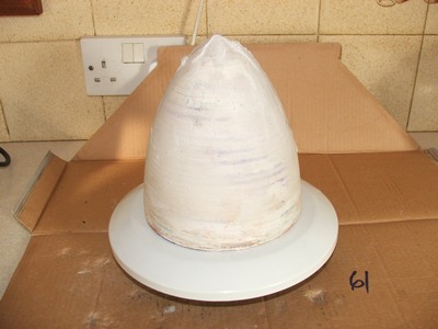

  i made a nose for the mill  but it dident look right.
  it was made from a ceiling fan /light.  i stripped one down to see what was inside.
  but later i stacked sum bits together and it looked like a prop nose.
   all made from metal i got gas torch and soldered it.

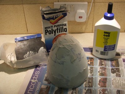

   now i needed sum bondo or car body filler .
   but i only had resin and talc and wanted to keep  that for new roter.
  but i did have sum drywall filler.
   so i used that it was only going to be a mock-up.
   but then i added sum water-proof glue .PVA type
    used the filler like bondo and i gote a nice new nose cone.

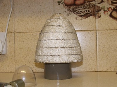

  i started with polystyrene . cutting out a disc at a time .
  i used a sharp craft knife same action as a jig saw .
  first marking it out on the sheet with a compass and pencil .
  it was a old bit rubbishy scrap that was laying around.
   i made each disc smaller as it got taller.
   soon i had a pile of round discs.
    next thing was to glue them together . but with WHAT?.
    i know sumthings melt  polystyrene . so i tried white silicon sealant .
    it worked great. was the first time ive tried to glue it.
  i did leave it over-night to set.  but it worked so well.

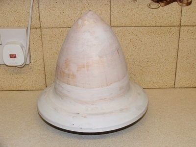

    so then i could start to shape it. a surform tool worked well  and sum 40 grit
sandpaper.
   but now i had a problem as i couldn't sand the white silicon . it was like soft rubber.
  i used a sharp blade and just sliced it off.

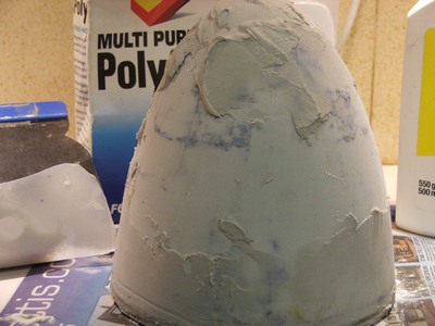

   then again i used the filler and pva wood glue. also water.
  to much wood glue and its impossible to sand down.
   as it was taking shape i cut a ply disc and stuck it on the bottom.
  then i found a round metal plate type thing.
 i screwed that to the plywood disc.
    more filler and sanding.  this was done a bit each day or evening.
   or when i had time.
   well now i could see that this shape was much better .
  then i finished the surface with water mixed with pva glue.
  letting it dry each time.
   using paint i had . it got a finish on it.

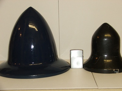

   but its all good fun doing a new nose job for my mill.
  as i was making it i thought i could use the nose as a plug. or a male mould.
  glass over it then make a female mould.
   but i dident want to start making noses in fibre glass.
     it was only fun.   my wife cant beleave i made this thing .
     the finish pic has got a zippo in the middle for size .
     you can see how it went with the pictures .
