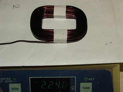

Re: cut in speed. (3.00 / 0) (#3)
by blueyonder on Mon Mar 24, 2008 at 08:39:22 AM MST
 hi flux .thanks again for the good advice .
   after much thinking about what you said .the wire could have been a bit more heavy.
  i wound a coil from 14awg .i put 55 turns on it.
  the legs were a bit thin and coil wasent at full size.
  but as it happend i had enough wire to make a new coil using 12awg.

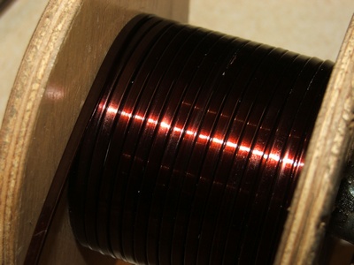

  but first i must explain about the wire .
  its 14swg  flat or maybe can be called oval.
  its to a military spec and the enamel is verry good.
   so its .062thu wide - .048thu thick.
  or 1.68mm wide - and 1.26mm thick.
   one meter will weigh  28 grams.
  i am not trying to confuse you with all this. just trying to help you understand
   about the wire i have.
  so i wanted to try wind a coil to see if it was possible to make one from this flat
   wire.
   also a few pics .
   i dont think you will need the pics as your exppearances  can tell you without them
 but have added them anyway.
  so what i have now is one coil at 40 turns .its 224 grams in weight.
 it comes inside the coil size ok. the legs arent to thick less than 3/4" each.
  with a bit practise i could wind them neater. for the 2x1 mags.
   its possible there's to much wire there .
   now i need to ask you.  can i make six coils from this flat wire.
   i think it will alter the cut in speed. so could you explain what i will be looking
   for as to cut in speed-  number of turns per coil.
  this is new wire . i can make six coils for £15.00 .
   but as i only have one i need to order the rest of it.
   if i said i had a good feeling about this wire. it might just make me happy.
   as to whether it will make for a better mill im not sure.
   in the other reply to you i said spring is in the air.
  now its snowing and i am sneezing . i spoke to soon.
