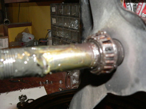

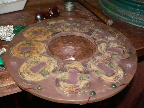

Sorry for the blurry picture.  This is a 10' machine that's been flying on a really good site now for 2 years.  It's the first bearing failure I've seen.  This wind turbine has 2" dia round magnets in it, 48V and the coils are 105 turns of #15 gage wire. The owners claim that they often see a steady kW 24/7 for the most part.  On cloudy weeks when they get no solar, this runs their whole house.  I'm not sure of their energy consumption but it's a fairly 'normal' house with electric fridge, dish washer, cloths washer/dryer and in floor radiant heat (which means pumps are running).  At any rate, the bearing only lasted two years.  Could be we didn't grease it well enough, could be that its a low quality (or too small) bearing.  Easy fix anyhow.. at least for two more years!
This is the vinyl ester stator from the same machine.  It shows definite signs of getting hot... but I think it's OK (maybe it won't get worse!)
Rich putting the same machine back together with new bearings.  We've also been busy since Nicaragua building new machines.

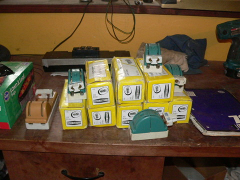

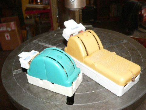

This was my souvenier from Nicaragua.. a bunch of nice big knife switches form the hardware store.  You just can't find stuff like this around here.
Another shot of the 30 amp knife switch (double pole double throw) and the single throw 60 amp switch.  We'll be offering these soon on our shopping cart, I think they're cool.  If you take the cover off they're just like any other 'antique' porcelain knife switch.  I have a bunch more of these coming.

I am down on the list for [unspecified #] knife switches and at least one of the Doc Wattsons. Been looking for both for spring installation.

Bearing failure:
A friend of mine when I told him I was not going to put a seal in suggested that I pop the spring in the seal and install it. He says that there would be no or very little mechanical friction/resistance but this would still offer about 50% protection against rain and snow. But then again as you indicated first bearing failure you've seen just a thought.

DanB,
 Did the hub feature a 'rear-seal', from here, it looks like the weather may have washed it out. I know the spring loaded hub seals can make it tough to R&R hub assys and make it difficult to re-pack the rear bearing. I always use great care when I encountor one on a hub. Most of the time its gotta be replaced, because they can be rough to remove(when there rusty, etc).

       With tapered bearings they are designed to have about a 0.002" preload depending on size. When I set tapered bearings at work I generally go or around 0.001-0.002" end float so when the gearbox gets up to temp the expansion will give the required preload.
       As a wind genny only does low speeds (200-300 rpm) I dont think the bearing would heat up too much so personally I'd go for a zero end float/preload. Also with grease make sure they are fully packed with grease and the seals on each end have some crush on the seal journal. Petroluem jelly on the seal face and in the seal cavity ensures the seal will be lubricated long term and it does help in wear prevention on the sealing journal.
       Here's thought on bearings for the larger type turbines. Have 2 tapered bearings back to back set with about a 0.001" end float then about 5-6" down the shaft put a spherical bearing. This arrangement is widely used in gearbox's and would lend itself to RE on larger machines.

  i got those exact same knife switches in costa rica. must be a latin american company supplying all the local countries. my brother used them in his system and i think i have one or two left. i'll have to come up and compare them.

 Insulate the stator connections before it goes back out . Polyurethane caulk . That stuff stick to anything if it's clean . Could be loading up between Two phases with rainy weather. Just had to butt in there .

Have you changed your method of assembling the hubs without the rear seal? I was under the impression you were not installing them and this is why I brought up the recommendation made to me i.e. removing the spring in the seal to reduce mechanical friction.
Just curious what is your latest method since I am slowly approaching this stage of assembly.
