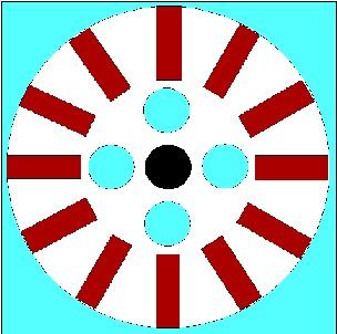

Would not his produce 6 phase..??..
Hi: Would not this coil layout produce 6 phase AC?? I tried to leave some space in between so you could see where the coils came down on the other side. Yellow is phase 1, pink phase 2 etc.. then it repeats when you get to the north again, I.E. one full cycle, then the pattern continues until you get all the way around.. each sine wave would be 60 degs in front, or behind depending on how you look at it, of the other..most of the magnets solid red lines are covered up by the coils, so I used the dotted lines as visual extensions just to show you where they end.

  Looks like 3 phase to me... You could probably wire it for 6 phase but I don't see any advantage over 3 phase.  Basically the same thing as shown below...
  Basically 3 single phase alternators potted into one stator and each phase is off slightly.

Yeah, that looks like 6 phase to me.
The only improvement over 3 phase would be the improved density of copper in the air gap. To my knowledge 3 phase does a fairly good job, providing the turns are overlapped, and not distributed as in the common 12/9 arrangement, which has the same density as any single phase winding. I'm sure you're aware of this, but not everyone is.
If you are interested in the benefits of 12 pulse rectification, take a look at US patent 7277302. What is not mentioned in the patent, is that particular topology requires a transformer KVA of .2p when configured as an autotransformer.
The only disadvantage is the 2 required interphase chokes.

I contend that it is still 3 phase.
The first and fourth coils will be 3 * 60 deg out of phase, or 180 degrees.
If you now end for end the start and finish of the fourth coil, they're now in phase.
Same with 2 & 5, and 3 & 6.
If you insist on calling it 6 phase, and rectifying seperately each phase, all you're really doing is a jerry-rig rectification scheme.
Consider a Fisher and Paykel. It has 42 coils. This does not make it a 42 phase machine. You can seperate the coils from each other, and rectify each individually. It's still only a 3 phase machine. (Ignoring for now the later magnet arrangement which produces a 7 phase machine).
Because the 180 deg phase shift can always be inverted and made in phase, any poly phase machine will always have an odd number of phases.

-Just had one hell of an AH HA moment.
I take back what I said earlier.
Amanda's right, the phase shift is 60 degrees, and you can't have an even number of phases.
If you want 6 phase operation, build one set of coils with 58/100 turns and connect in  WYE, with the 100 turn coil in Delta. you will get a 30 degree phase shit.

It is 3 phase.  Trust me and everyone else or your head will explode.
I made some 4 magnet, 6 coil, PMAs.  A bit different but close enough.
My head almost exploded tring to figure it out, and it is 3 phase.

It's NO phase until you put some wires to connect it.
Intrinsically it is a 6 phase layout if you take the starts from each coil as the phases. In real life it is the layout uses in all 3 phase machines wound as a 2 layer winding ( much more common in Europe).
For 3 phase you take the connections as each coil progresses as A, C reversed, B.
In other words you take the phase connections from every 120 displaced coil if you want 3 phase. Take every coil if you want 6 phase.
The concentric coil convergent pole winding is more common in N America, this configuration is by far the most common in the rest of the world.
Don't get hung up on the strange 12 pole 9 coil arrangement seen here, it just doesn't exist in the real engineering world. It is a useful dodge that works well with axial machines where winding space is very restricted in the centre. You will never find commercial machines wound that way.

Hi: I guess it would be 3 phase if I want.. I will just reverse wind the second coil in each pair for all three sets (phases) that it would make. Then you have 1-4, 2-5, and 3-6 with 4,5 and 6 wound in the opposite direction. I will cut my copper in half and thin the stator with 12 turns per coil but 36 coils per phase still at 432 turns per phase. I should then be able to easily have a 3/8" or 1/2" thick stator and a rotor gap of 1/2" or 5/8". With the 1" thick neos I will easily get my 1T field at that gap. I just wish I could see in my head how the 3 waves will fill out evenly (at 120 degs) a full cycle even though any one of the coils moves only half way from like pole to like pole.... I definitely will build the rotors first and do coil section samples for testing, before I dare make the whole stator...

It is 6 phase if you want it to be. It really depends on how you choose to recitfy it. If your going to DC then just put a bridge rectifier on each phase and then tie them together afterwards. This will also work for any other number of phases you want.

  1. phase would have 12 coils per magnet pair (or some less dense equivalent).
  2. coils the way you drew them means coils 1, 3, and 5 are the same as coils 4, 6, and 2 with the start and end terminals swapped.  That's 3 phase.

You can't have an even number of phases!
12 coils would work out to 4 sets of 3.
